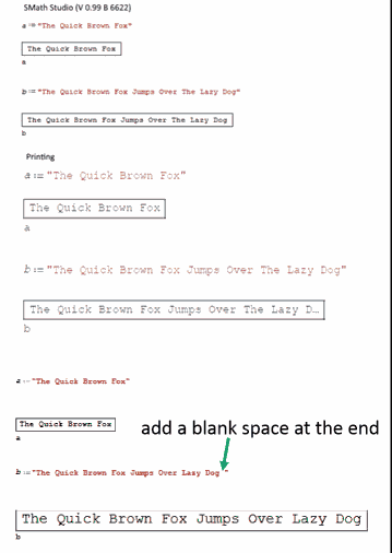

adding a blank space at the end of the sentence solves the problem

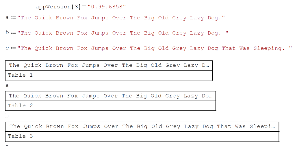

I wish it where that easy. Unfortunately, as previously discussed, as the number of characters increases, the more blank spaces you need to add in order to display the full text. In my particular situation, I am dealing with thousands of different lengths, having to figure out exactly how many spaces to add to the end hardly seems like a "solution," but rather a work around... which was also previously discussed.
Here is an example of what I mean. "a" has no space, while both "b" and "c" have each one space. As you can see "b" has 3 missing characters counting the blank space on the end, while "c" has 4 missing characters.

So... I did some testing and here are the results.
String Length....Spaces Needed at end to display full string
1-12...............0
13-46..............1
47-70..............2
71-94..............3
Every +24.........n+1
If printing portrait mode, default font size you wont need more than 3 spaces.
Landscape mode will need 5 with default font size.
For those who are interested...

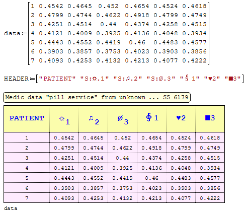

In this example [LM from Carlos], to ease the printing, the global table 'Sol'
has been rounded to 9 Decimals. This does not affect the full 15 of 'x' parameters.
"thousands of different lengths" of what ? ... poetry, numerical values ... ?
Matrix [round,n] in the collapsed area ... done SS 6179.
Levenberg_Marquardt_Code_CBG Model Copy.sm (67.9 KiB) downloaded 1570 time(s).

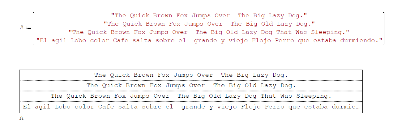

I do not know what your objective is, the case I described was for use in titles, otherwise, you can use
a matrix without worrying about using spaces as in the example below.
Table_Space_1.sm (6.68 KiB) downloaded 1466 time(s).

I think that for now the only solution is to add the spaces.

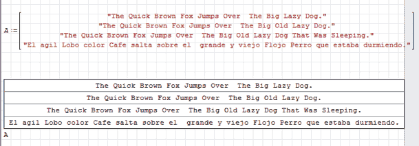

Hi. Saving as pdf seems don't having problems.
Table_Space_1 Save as pdf.pdf (42.29 KiB) downloaded 809 time(s).
Table_Space_1 Foxit Driver.pdf (54.28 KiB) downloaded 835 time(s).
Table_Space_1 Microsoft Driver.pdf (123.87 KiB) downloaded 805 time(s).

It just shows a numerical problem solved. The 15 native decimals result in
messy *.PDF as well as hard print. The demo exemplifies reducing the print
width if you are concerned with numerical values.
On the other hand, you can add any number of lines of text within a native
Smath matrix of data. Add line(s) anywhere => the text lines will be in
Smath default from the quote system "The wise fox ..."
I believe [not sure] you can add other symbols in the text vg: music symbol.
In most instances, final doctoring is only possible on original project.
