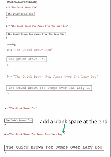

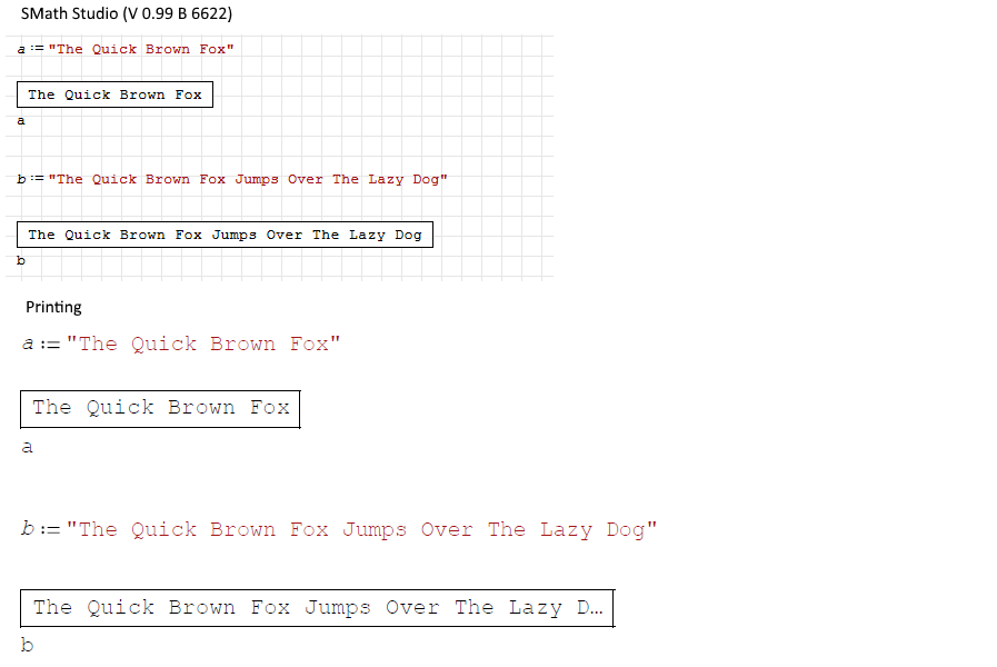

Thanks for the work with this plugin, it has proven to be a very useful and much needed feature.
I am however having one small issue. My table displays fine within SMath, but when I print, depending on how many characters there are, the table cuts off.
This is only when I print.
Is there something in the settings I am missing?
All settings are default in the attached example.
Thank you!
Confirmed. Unfortunately string scaling is driven internally by the .NET framework (here the ssue is how letters are spaced), so there aren't easy fixes. I'll think if I can do something however, thank you for reporting.

adding a blank space at the end of the sentence solves the problem
Carlos

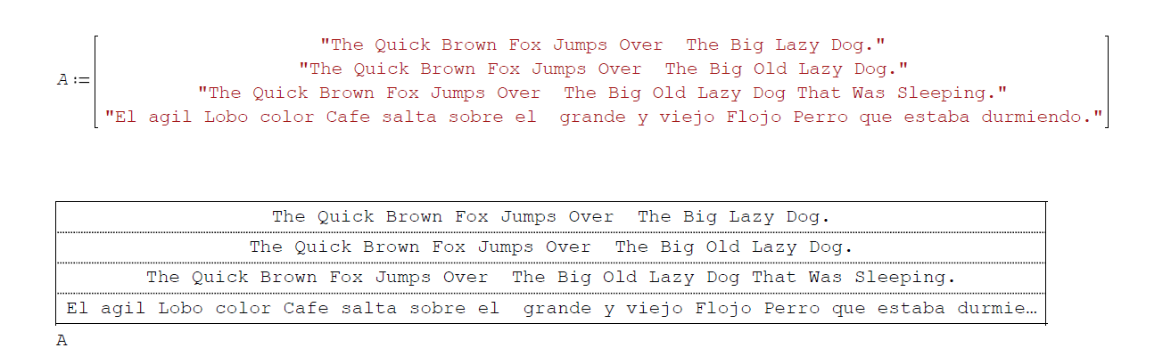

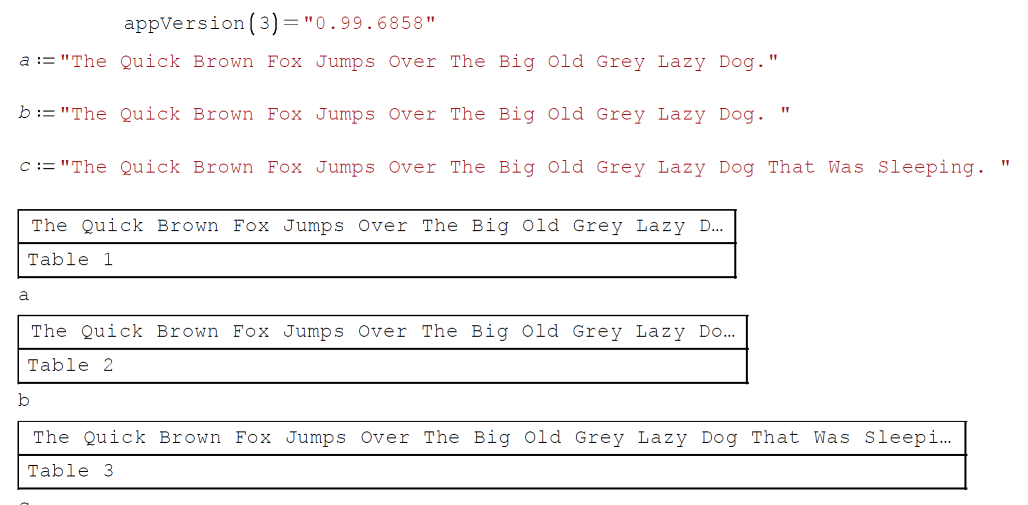

I wish it where that easy. Unfortunately, as previously discussed, as the number of characters increases, the more blank spaces you need to add in order to display the full text. In my particular situation, I am dealing with thousands of different lengths, having to figure out exactly how many spaces to add to the end hardly seems like a "solution," but rather a work around... which was also previously discussed.
Here is an example of what I mean. "a" has no space, while both "b" and "c" have each one space. As you can see "b" has 3 missing characters counting the blank space on the end, while "c" has 4 missing characters.
Perhaps there can be a way of counting the characters in a string and then having some concatenating function add the spaces automatically depending on the length?? Just a thought...

So... I did some testing and here are the results.
String Length....Spaces Needed at end to display full string
1-12...............0
13-46..............1
47-70..............2
71-94..............3
Every +24.........n+1
If printing portrait mode, default font size you wont need more than 3 spaces.
Landscape mode will need 5 with default font size.
For those who are interested...

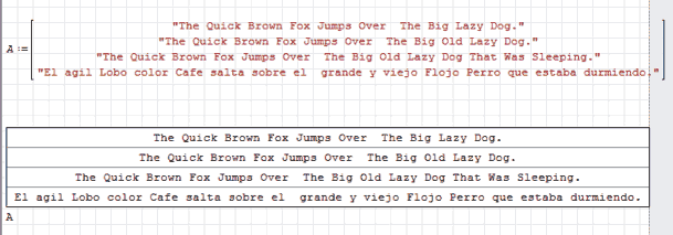

I do not know what your objective is, the case I described was for use in titles, otherwise, you can use
a matrix without worrying about using spaces as in the example below.
Table_Space_1.sm (6,68 КиБ) скачан 1466 раз(а).

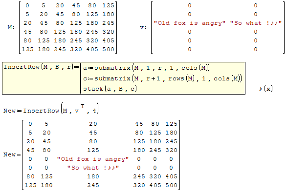

On the other hand, you can add any number of lines of text within a native
Smath matrix of data. Add line(s) anywhere => the text lines will be in
Smath default from the quote system "The wise fox ..."
I believe [not sure] you can add other symbols in the text vg: music symbol.
In most instances, final doctoring is only possible on original project.

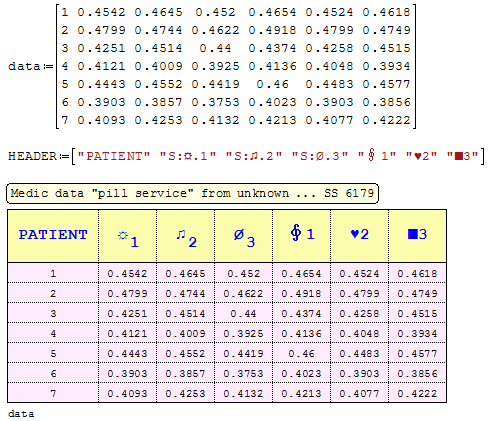

I'm trying to use UNICODE symbols in tables, but they just don't work. I get \numbers\ instead of the actual symbol.
Is there another comprehensible set of symbols I could use inside this region?
Thanks!

Is there another comprehensible set of symbols I could use inside this region ?
In the mean time: from Win Charmap.
