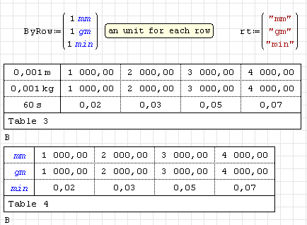

Did I get it right that the unit summary is for scaling the data by line?
By columns, by rows or global (single unit/scale factor)
[edit] attachment updated using the latest plugin's XML scheme
units.sm (21,03 КиБ) скачан 1614 раз(а).
IVR 16.02.2014 13:08:00, Martin Kraska 16.02.2014 07:55:00, Mikka 16.02.2014 07:59:00, ioan92 16.02.2014 08:39:00, Radovan Omorjan 16.02.2014 12:27:00, Andrey Ivashov 16.02.2014 17:51:00, sergio 17.02.2014 04:15:00
Thanks, control by matrix dimension seems clean and easy to remember.
I'd prefer the unit summary entries not being converted to base units but rather being displayed as specified (perhaps with a bit of string processing to remove spurious curly braces and to replace ^2 by ³ and ^3 by ² )
There is, of course, a workaround by hiding the summary and writing the units as strings to the stub or header - with inherent danger of inconsistency.
I would like to add another feature request: formatting with specified number of significant digits.

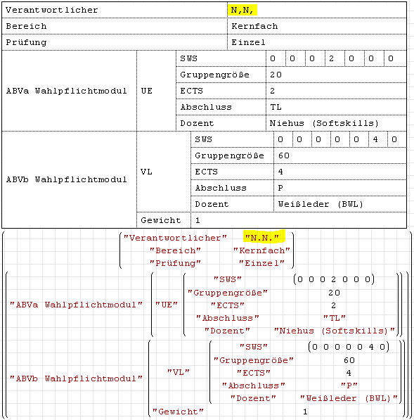

Unexpected results in Table Region. All but the first submatrices are collapsed to some strange number. Something went wrong...
NK TM1 13.sm (38,49 КиБ) скачан 1584 раз(а).
Davide Carpi 21.04.2014 13:36:00
#38 Опубликовано: 21.04.2014 13:38:50
Thank you Martin, bug added in the BTS (SS-120)

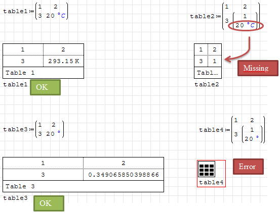

Here is another small problem with nested matrices. I added this to BTS issue SS-120.
Davide Carpi 20.05.2014 19:22:00, Andrey Ivashov 23.05.2014 17:19:00
