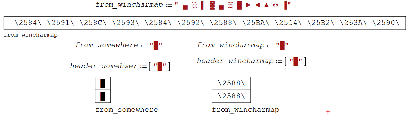

Thanks for the tip, Jean, but it is not working either.
I compare the behaviour of a █ symbol a got somehwere in the internet versus the one provided by win charmap and get the following:
By the way, both SMath and Table Region are updated.
#102 Опубликовано: 24.08.2020 11:10:29
I dropped dead on that !
Try the native SS 6179 work sheet.
Table Medic Data.sm (10,82 КиБ) скачан 1555 раз(а).
#103 Опубликовано: 24.08.2020 11:39:37
1. WinCharmap ... TT OpenSymbol [TT = True Type]
2. Browse the symbol/select ... it shows in the line
3. Copy/paste in header "paste in there"
4. Nothing shows ... Ah !
5. Paste then type 1 it shows symbol ... backspace 1
6. Now you just have symbol
7. You can accumulate symbols in the select/copy line
8. Browse/select, browse/select ...
9. Copy, paste in header for all those symbols
10. Like before: paste, type 1 ... backspace 1
#104 Опубликовано: 29.08.2020 12:24:26
João Felipe Seráfico Melo
7 сообщений из 62 понравились пользователям.
Sorry for the delay in replying. It still doesn't work.
#105 Опубликовано: 29.08.2020 15:27:23
Please, attach the document for doctoring.
It may concern a bug in your SS version.

#108 Опубликовано: 09.09.2020 04:48:20
PLUGIN UPDATED SMath Studio 0.99.7542 and later
  • [SS-4628] fixed display of encoded strings
sergio 09.09.2020 05:47:00
#109 Опубликовано: 09.09.2020 10:04:13
Davide, it is working now! Great job!
Jean, sorry for not replying you. In fact I have no idea how to check what you mentioned, but I should have given you a feedback anyway.

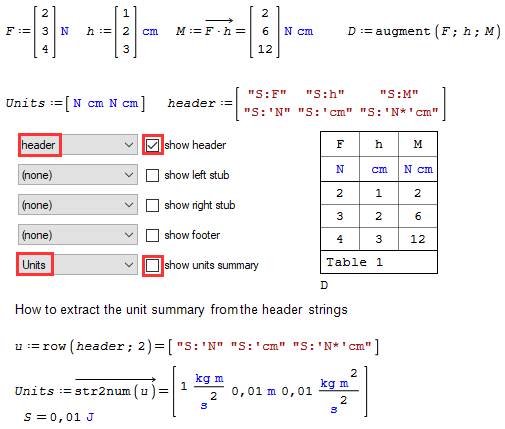

#111 Опубликовано: 09.08.2023 20:17:25
Feature request:
I propose to allow the units summary to accept also vectors of string-coded units (as used in the header)
Benefit:
- Display of the unit summary would be possible with nice pretty printing
- Guaranteed consistency between units applied to the data and displayed units.
In fact, it would be best to avoid encoding and to dirctly specify the units. Yet that seems to be impossible as long as the storage is only in base units.
The example below shows how to extract a valid unit summary out of a header with string-coded units.
Tableunits.sm (18,42 КиБ) скачан 1584 раз(а).
