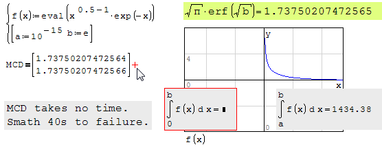

#9 Posted: 1/28/2023 10:46:03 AM
For short calculations it's a good alternative, but it seems very-very slow when long iterations are needed.
In some instances, Smath is slightly faster than Mathcad 11.
However, almost not observable.
In other instances, Smath is horribly slow.
1 min Julia in Mathcad takes over 2 hrs in Smath
Same observation Fourier CoC ... and more.
Please, attach your document for Smath Community to doctor.

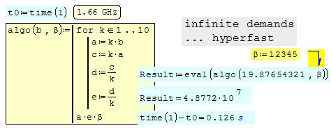

#15 Posted: 1/28/2023 8:03:55 PM
598 likes in 1,380 posts.
it is just for test purposes not a real task.
And speed of your test code fails under SMath drastically.
But we all know these issues. For huge iterations SMath is not useful.
Anyone who plans to use this software should know this, SMath is a one-man show.
There are no paid programmers who can give all their time to SMath.
Only a handful of developers are included in writing and enhancing the code.
And they are doing this in their spare time, without any charge.
Maybe Andrey improve iteration speeds in future, who knows.
We can request something, it is up to Andrey include or improve that.
It is what it is, a free software which gives us mathcad interface.

Maths algo DEMANDS.sm (5.85 KiB) downloaded 1209 time(s).
