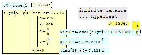

#17 Опубликовано: 29.01.2023 09:52:11
Arie
Arie
speedtest.sm (4,53 КиБ) скачан 1242 раз(а).
This is the file I made exclusively for speed check. There is no need to improve this calc by modifying it's structure, it is just for test purposes not a real task.
I started to use Mathcad in the last century (V6.0). I made several calculations for example to simulate transient temperature rise of electrical rotating machines. I know there are better tools but I am familiar with MathCad that's why I am looking for a similar sw.
Just for demonstration purposes, I've been able to increase the speed of this calc ~25% on my machine just by using vectorization rather than the for loop. It's still not near the performance you'd like, but just goes to show there are often things to be done to improve calculation speed. Vectorization isn't always possible in some algorithms, but when it is, it's generally faster.
speedtest.pdf (35,36 КиБ) скачан 763 раз(а).
speedtest.sm (8,36 КиБ) скачан 1248 раз(а).

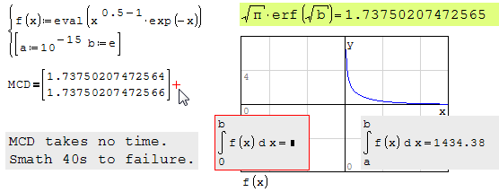

Maths algo DEMANDS.sm (5,85 КиБ) скачан 1209 раз(а).

#20 Опубликовано: 29.01.2023 18:36:37
In the last few days I also found many points where SMath is superior to MathCad.
You can't be more correct.
SMath may be behind than MathCad speed-wise.
But in terms of usability, features, visual aspects SMath is way better.
Just plugin support is a huge plus single alone.
