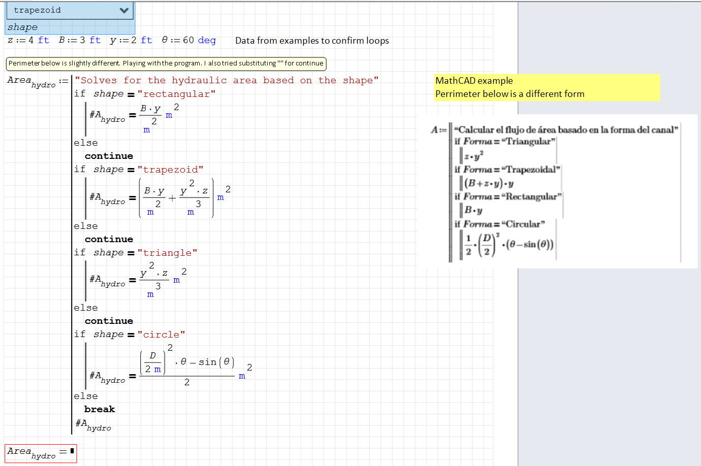

I have two forms of the program in this file. I would be happy
  • Get the program to work
In the file is a snippet of the MathCAD program I was using to confirm the structure

Thanks for the attachment. I remember a similar MathCAD file
It bothers me that you cannot open my 0.99.7610 SM files ...

I do have a θ per the screenshot above. Issue is in program structure.
Thank you for looking at this.

you have 2 little mistakes
shape must be a string and you are passing it an integer
and second I think that in the functions you should use the assignment (: =)
and not the symbol (=)
Interesting.

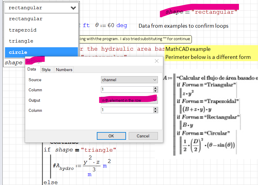

I was playing with the equation definition ":=" in lieu of "="
I also have what appears to be the correct output from the DropBox list ... apparently not a string? ... your index DOES work

@churichurro
I didn't notice that you deleted "continue" in the else part of my file. That was the issue!
"ELSE" needs to start the next "IF" loop, therefore it's nested. I'll clean it up and re-post

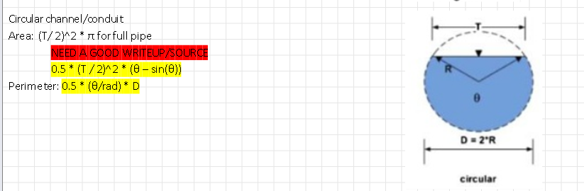

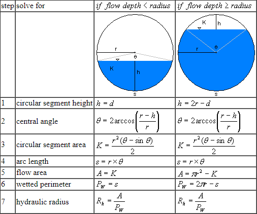

Anyone have a good description, write-up, or weblink that derives these two formulas? (Not Wikipedia)
As promised above.
This made Manning so much easier. Thank you all
Hydraulic Radius Final.sm (16.32 KiB) downloaded 721 time(s).

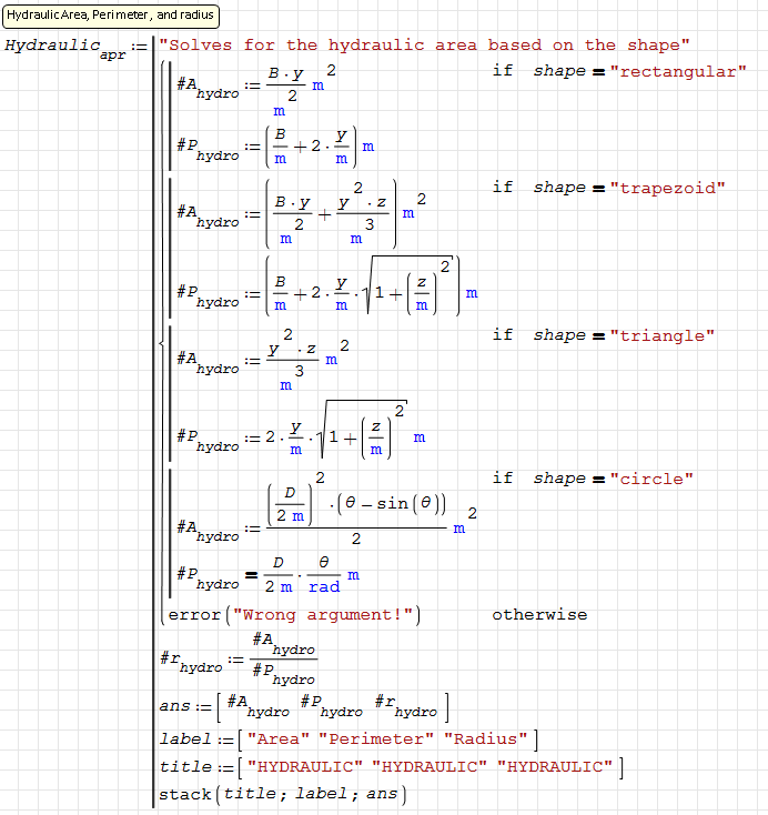

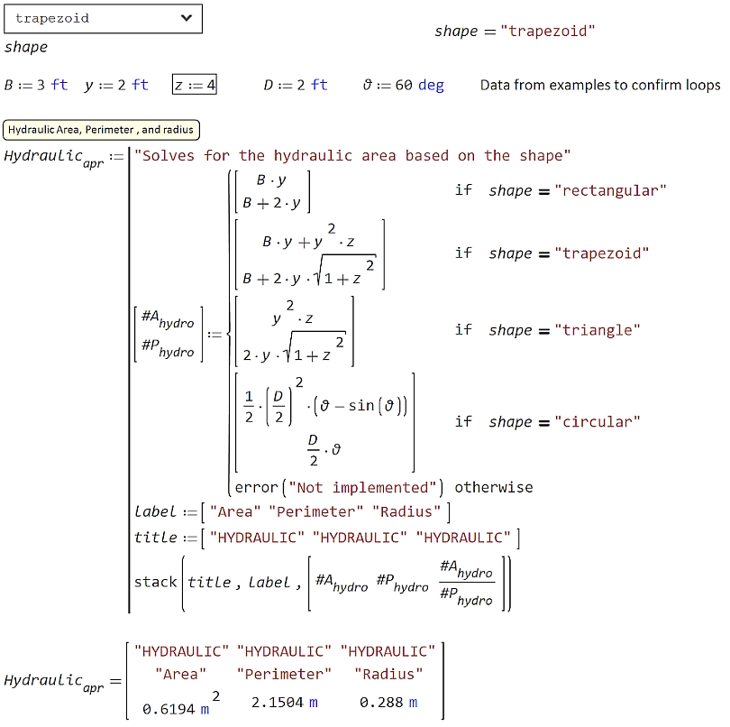

Thats's nearly a prime example for using cases instead of if/else:

Anyone have a good description, write-up, or web link that derives these two formulas? (Not Wikipedia)
Wikipedia has turned about useless in too many search !
Visit this site + calculator.
https://www.ajdesigner.com/phphydraulicradius/hydraulic_radius_equation_pipe.php

For the partially filled circular, there is no escape from the Segment.
The only measurable is the height of the segment.

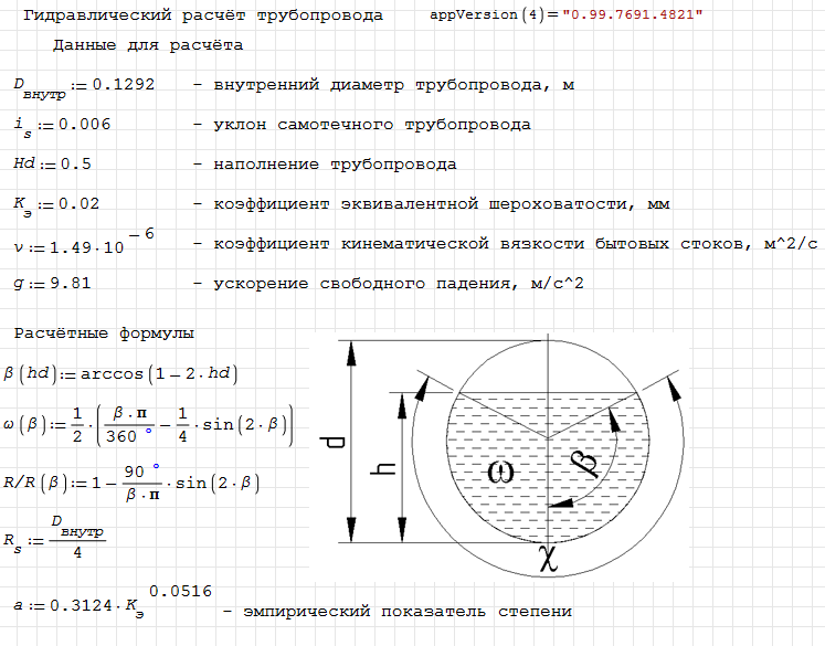

Some time ago I made similar calculations.
Hydraulic calculation (rus).sm (42.41 KiB) downloaded 756 time(s).
I've never heard of or used "cases"
Update, to add "IFs", Jean answered the question: click right hand most place holder, coma twice for one more if... again coma twice like before. Will be dissecting this function. Thanks to others who posted sheets.
Yep. Here with correct units:
Hydraulic Radius Final.sm (15.64 KiB) downloaded 717 time(s).

Hi. You don't need to divide by the units in the body of the procedure. Notice that z is the side slope, so it's dimensionless, equal to length / length, even eventually can have units, like mm/m. This is, given that z is the horizontal change per unit vertical change, it's usual to use one unit for horizontal change but another to the vertical change.
Alvaro,
I tend to use units wherever and whenever possible. I see what you mean with "z". This IS unitless, thank you for correcting this. I fixed the formula to omit units on my sheet.
I now see the units comment clearly
