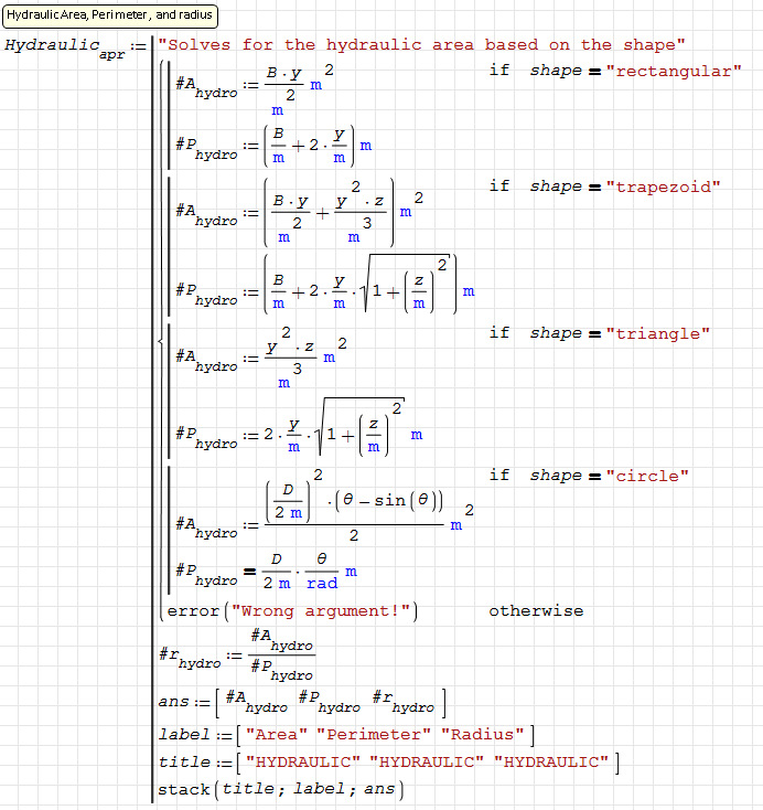

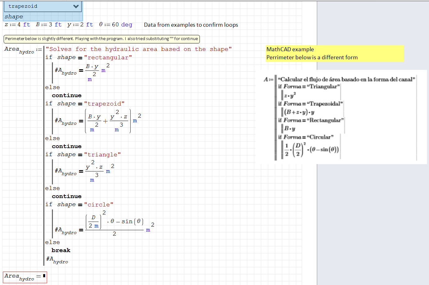

I have two forms of the program in this file. I would be happy
  • Get the program to work
In the file is a snippet of the MathCAD program I was using to confirm the structure
hydraulic radius.sm (213,85 КиБ) скачан 1167 раз(а).

#3 Опубликовано: 28.01.2021 20:24:14
Ruben Sidranski
Ruben Sidranski
Thanks for the attachment. I remember a similar MathCAD file
It bothers me that you cannot open my 0.99.7610 SM files ...

#5 Опубликовано: 28.01.2021 21:25:26
Ruben Sidranski
Ruben Sidranski
I do have a θ per the screenshot above. Issue is in program structure.
Thank you for looking at this.

you have 2 little mistakes
shape must be a string and you are passing it an integer
and second I think that in the functions you should use the assignment (: =)
and not the symbol (=)
#7 Опубликовано: 28.01.2021 22:56:05
Ruben Sidranski
Ruben Sidranski

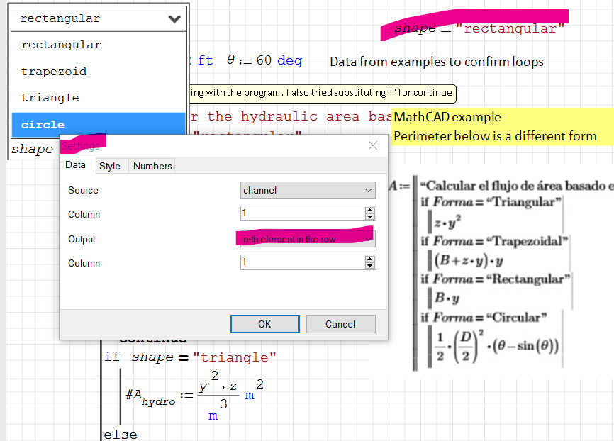

Interesting.
I was playing with the equation definition ":=" in lieu of "="
I also have what appears to be the correct output from the DropBox list ... apparently not a string? ... your index DOES work
#8 Опубликовано: 28.01.2021 23:05:13
Ruben Sidranski
Ruben Sidranski
@churichurro
I didn't notice that you deleted "continue" in the else part of my file. That was the issue!
"ELSE" needs to start the next "IF" loop, therefore it's nested. I'll clean it up and re-post

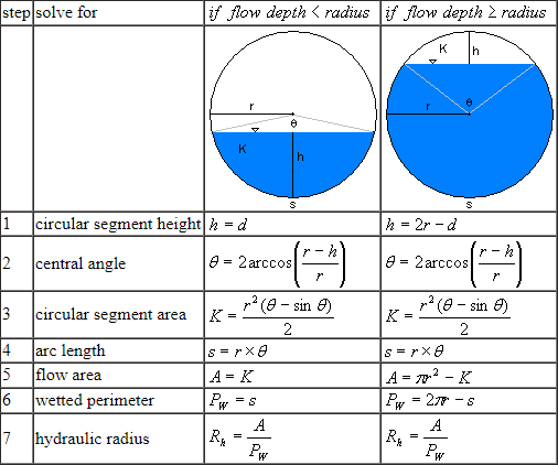

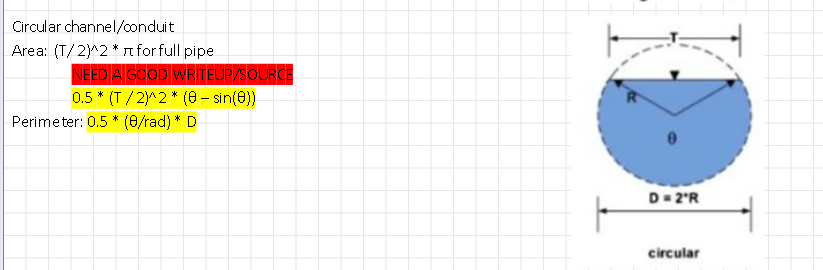

Anyone have a good description, write-up, or weblink that derives these two formulas? (Not Wikipedia)

#10 Опубликовано: 29.01.2021 04:07:23
Martin_B
Martin_B
22 сообщений из 84 понравились пользователям.

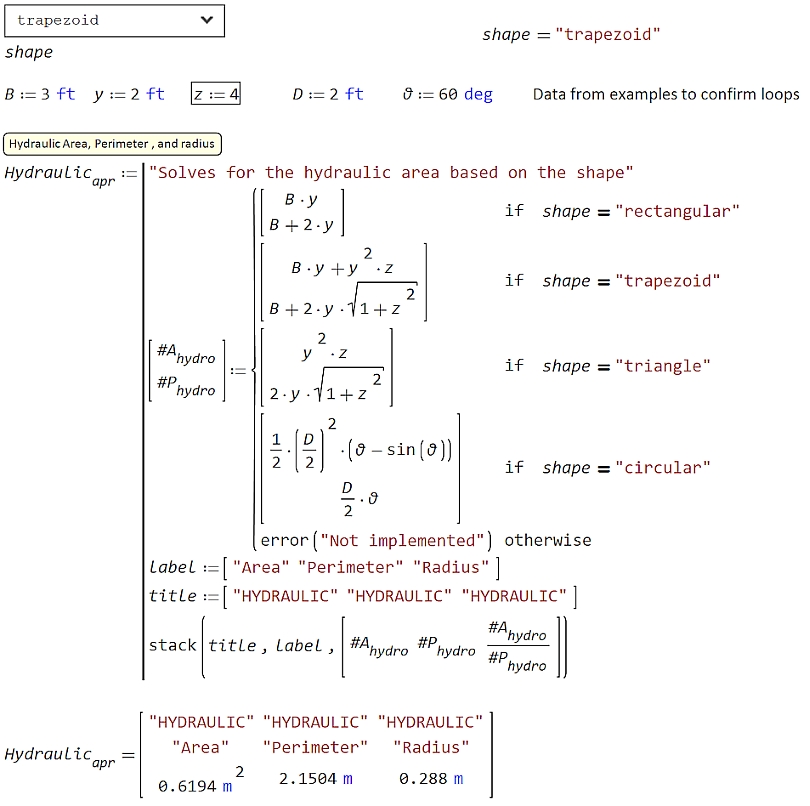

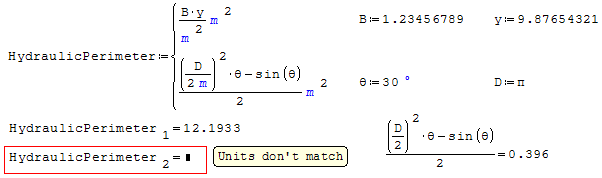

Thats's nearly a prime example for using cases instead of if/else:
#11 Опубликовано: 29.01.2021 07:01:12
Hi. You don't need to divide by the units in the body of the procedure. Notice that z is the side slope, so it's dimensionless, equal to length / length, even eventually can have units, like mm/m. This is, given that z is the horizontal change per unit vertical change, it's usual to use one unit for horizontal change but another to the vertical change.

Anyone have a good description, write-up, or web link that derives these two formulas? (Not Wikipedia)
Wikipedia has turned about useless in too many search !
Visit this site + calculator.
https://www.ajdesigner.com/phphydraulicradius/hydraulic_radius_equation_pipe.php

#15 Опубликовано: 29.01.2021 09:53:23
Ruben Sidranski
Ruben Sidranski
I've never heard of or used "cases"
Update, to add "IFs", Jean answered the question: click right hand most place holder, coma twice for one more if... again coma twice like before. Will be dissecting this function. Thanks to others who posted sheets.
#16 Опубликовано: 29.01.2021 09:53:47
#17 Опубликовано: 29.01.2021 11:35:38
Yep. Here with correct units:
Hydraulic Radius Final.sm (15,64 КиБ) скачан 1124 раз(а).

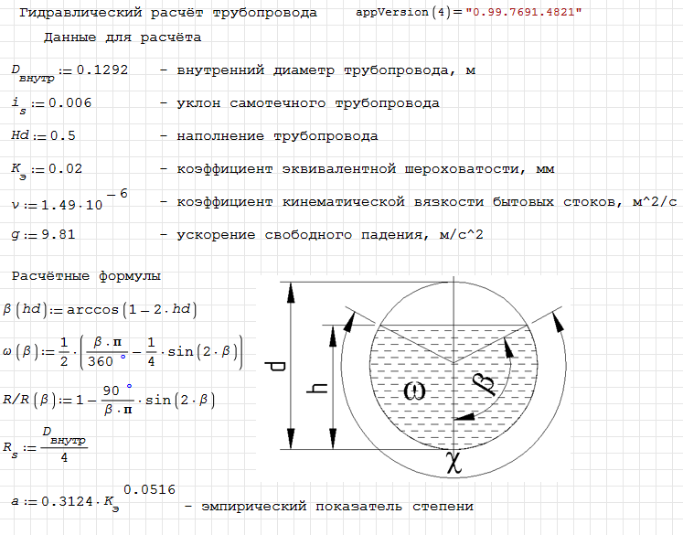

#20 Опубликовано: 29.01.2021 16:31:45
... modular, piece-wise from source unit-less.
Any polygon, partially filled thank.
Measuring the segment 'h partial filled' is another story.
