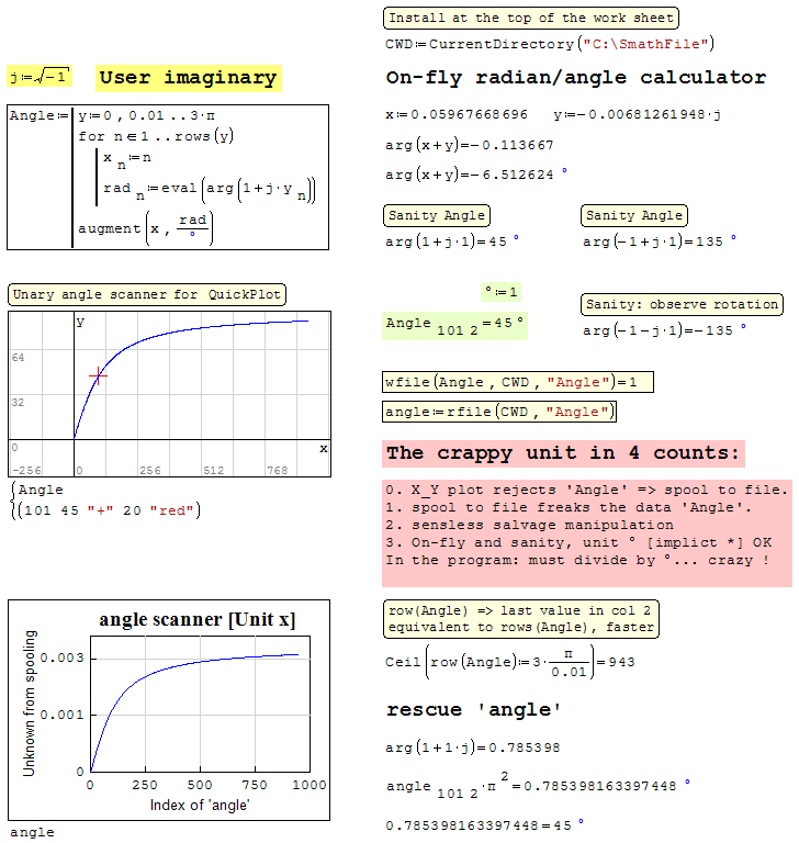

This the 'PJ" version [PJ = Pyjama]
1. Define imaginary user style 'j'
2. Don't re-use 'j' as index.
3. No need to spool to file, but X_Y plot
does not take unit ° in "Angle" [Not defined].
I have removed previous posting and work sheets.
Cheers, Jean
Angle Data 'j'.sm (9 KiB) downloaded 59 time(s).

#5 Posted: 4/25/2016 12:31:18 AM
... just watch the unit system in your Engineering projects.
Angle Data 'j'.sm (16 KiB) downloaded 50 time(s).
