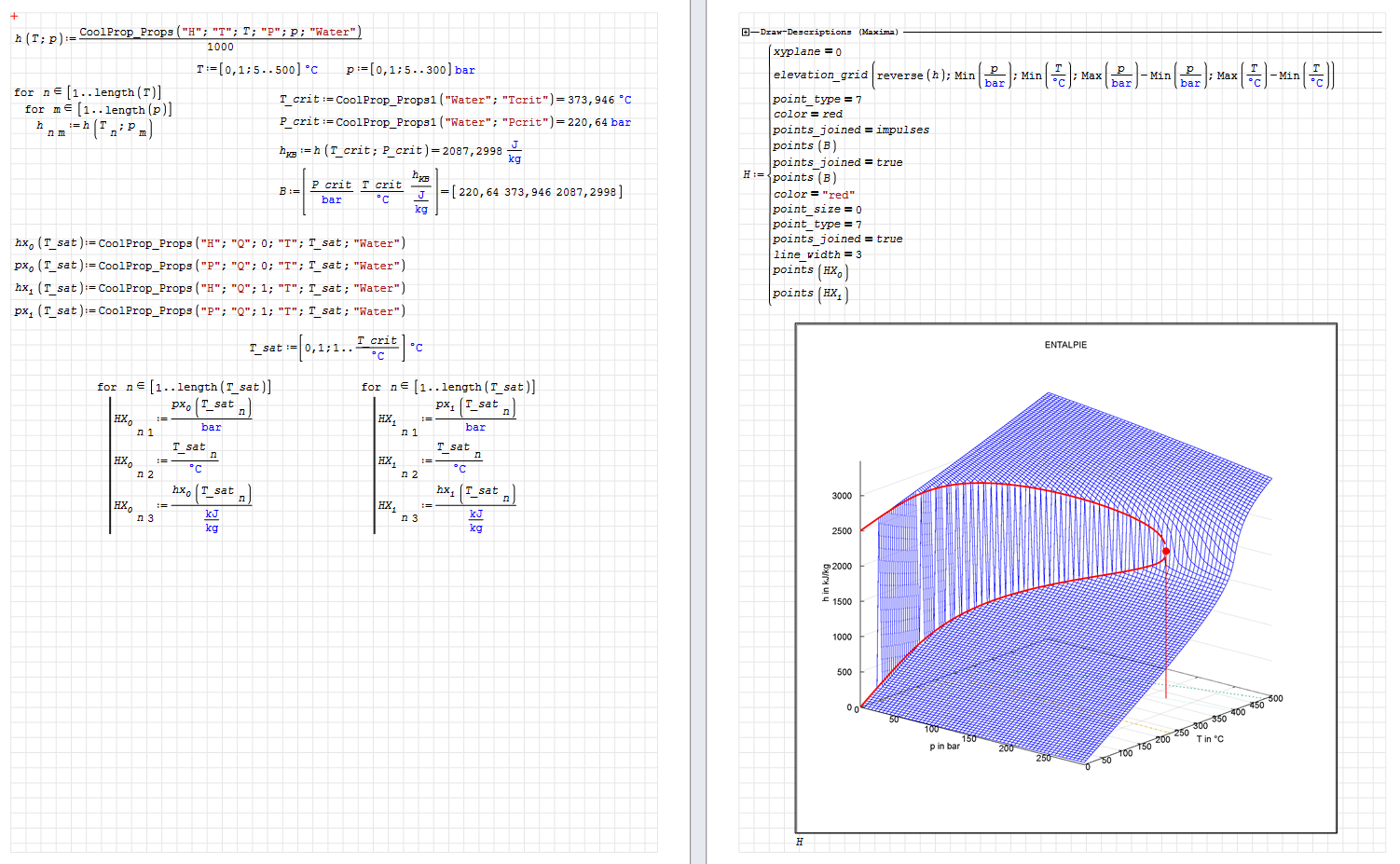

#8 Posted: 2/6/2026 11:03:04 AM
how can I add point B to plot? When I tried I make point or plot, but not both of them.
kriticky_bod.sm (202.22 KiB) downloaded 667 time(s).

#10 Posted: 2/10/2026 7:29:28 AM
Thanks for answer,
I tried to fix it and I ended with this. Still can t plot graph and point together.
kriticky_bod.sm (201.86 KiB) downloaded 620 time(s).
What should I do now?
Tomáš
Tomáš
#11 Posted: 2/10/2026 3:54:04 PM
You still have a negative h value (temperature difference). Reverse this (and also reverse the matrix). Then it should work.

#14 Posted: 2/19/2026 11:38:12 AM
Now I would like to add saturation curve. Is it better to go with matrix or function? And how can I do that?
I tried parametric function, but plot did not work.
krit_bod_2.sm (211.84 KiB) downloaded 621 time(s).
Thanks for answers!
Tomáš

#15 Posted: 2/19/2026 1:01:39 PM
I guess it is best to use the points object just like for the single point. Set points_joined to true, point_type to something convenient. Using a function will work only if that function is supported by the interface to Maxima, which probably doesn't apply to coolprop functions or interpolated functions.
#16 Posted: 2/22/2026 6:05:46 PM
I’m back. I tried to create line of points by maxima handbook. Handbook is really great, but I couldn’t figure it out. What am I doing wrong? Matrix seems right.
And i have another question. When I created plot of enthalpy I just wrote name of the "plot function". But in the manual, there is Draw3D("plot function"). Why is that?
saturation_curve.sm (194.75 KiB) downloaded 576 time(s).
Thanks for your help and patient, I really appriciate it.
Tomáš
Tomáš
#17 Posted: 2/23/2026 10:20:19 AM
Your data matrix isn't in the correct format. It is a one-column matrix of row vectors. Make it a real n x 3 matrix, then try again.
Also, you use different units when filling the data matrix (J/kg) and for the axis limits (kJ/kg).
As to the Draw3D command, see intro text to Chapter 3.
#18 Posted: 2/26/2026 12:23:13 PM
finally I’v done it! Thank you very much Martin! I think it looks great.
Now I would like to continue and mabye try to make something bigger and try to use Smath viewer.
Entalpie_pT.sm (156.56 KiB) downloaded 553 time(s).
Tomáš
Tomáš
