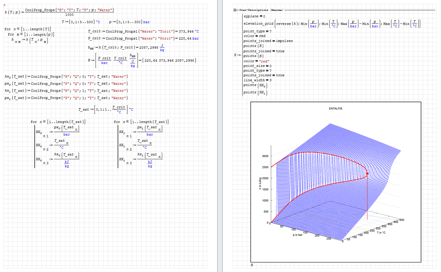

Hi, i would like to add some points to 3D plot. How can I do that?
And can i somehow make the plot smooth without using smaller steps in vectors?

#2 Опубликовано: 22.01.2026 14:08:14
You could try to create a mesh of triangles or quadrilateral objects. Then you are free to use a problem-adjusted surface parametrization.

Now I would like to add saturation curve. Is it better to go with matrix or function? And how can I do that?
I tried parametric function, but plot did not work.

#15 Опубликовано: 19.02.2026 13:01:39
I guess it is best to use the points object just like for the single point. Set points_joined to true, point_type to something convenient. Using a function will work only if that function is supported by the interface to Maxima, which probably doesn't apply to coolprop functions or interpolated functions.

I’m back. I tried to create line of points by maxima handbook. Handbook is really great, but I couldn’t figure it out. What am I doing wrong? Matrix seems right.
And i have another question. When I created plot of enthalpy I just wrote name of the "plot function". But in the manual, there is Draw3D("plot function"). Why is that?
saturation_curve.sm (194,75 КиБ) скачан 576 раз(а).
Thanks for your help and patient, I really appriciate it.
Tomáš
#17 Опубликовано: 23.02.2026 10:20:19
Your data matrix isn't in the correct format. It is a one-column matrix of row vectors. Make it a real n x 3 matrix, then try again.

#18 Опубликовано: 26.02.2026 12:23:13
Tomas Novotny
Tomas Novotny
1 сообщений из 15 понравились и 1 не понравились пользователям.
finally I’v done it! Thank you very much Martin! I think it looks great.
