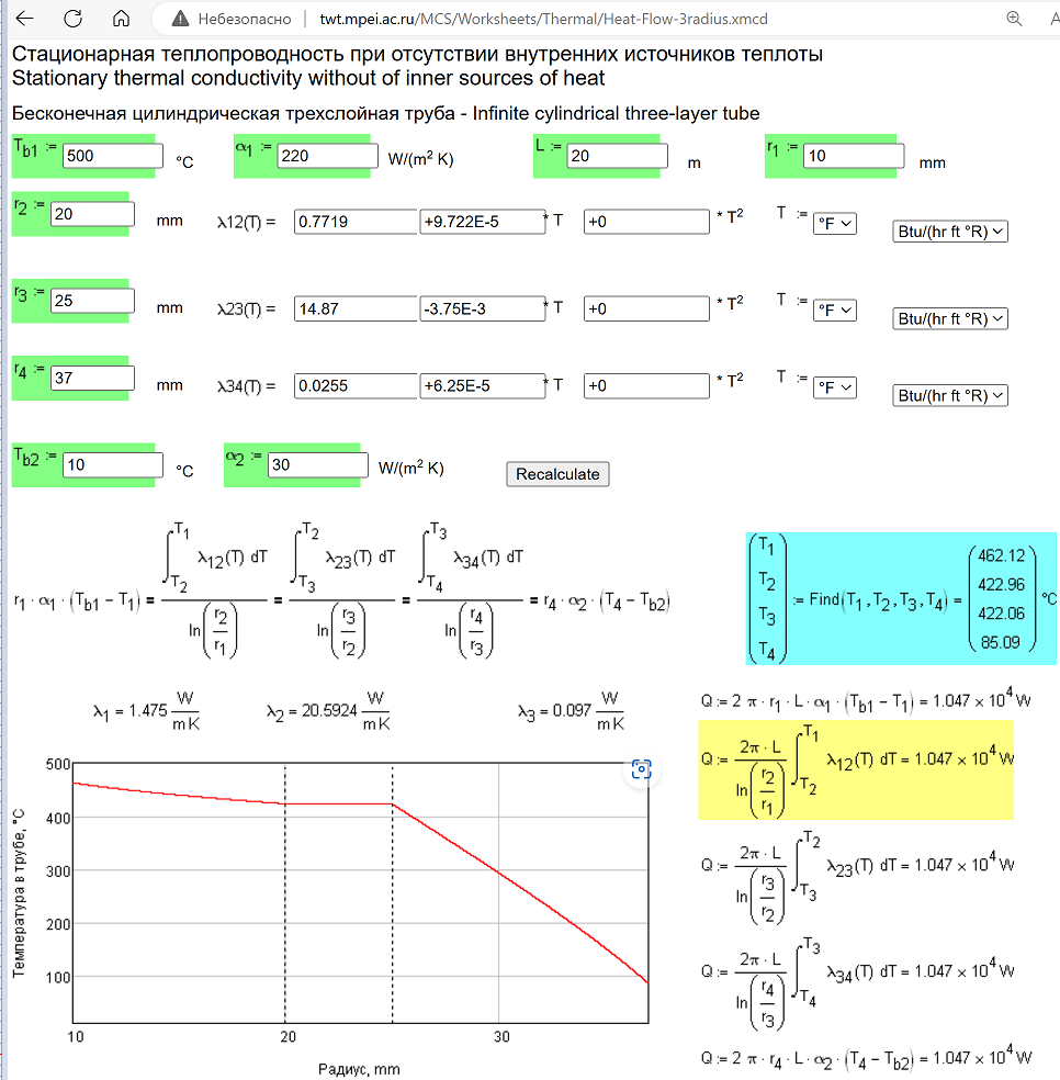

I would like to to sole the linear equations
F1=F2=f3=F4 with 4 unknowns T1, T2, T3 and T4
I can do it in Mathcad (given-find). but cannot in SMath ;-(
Help me please!
See please the Mathcad Calculation Server
http://twt.mpei.ac.ru/MCS/Worksheets/Thermal/Heat-Flow-3radius.xmcd
my SMath try in attach and

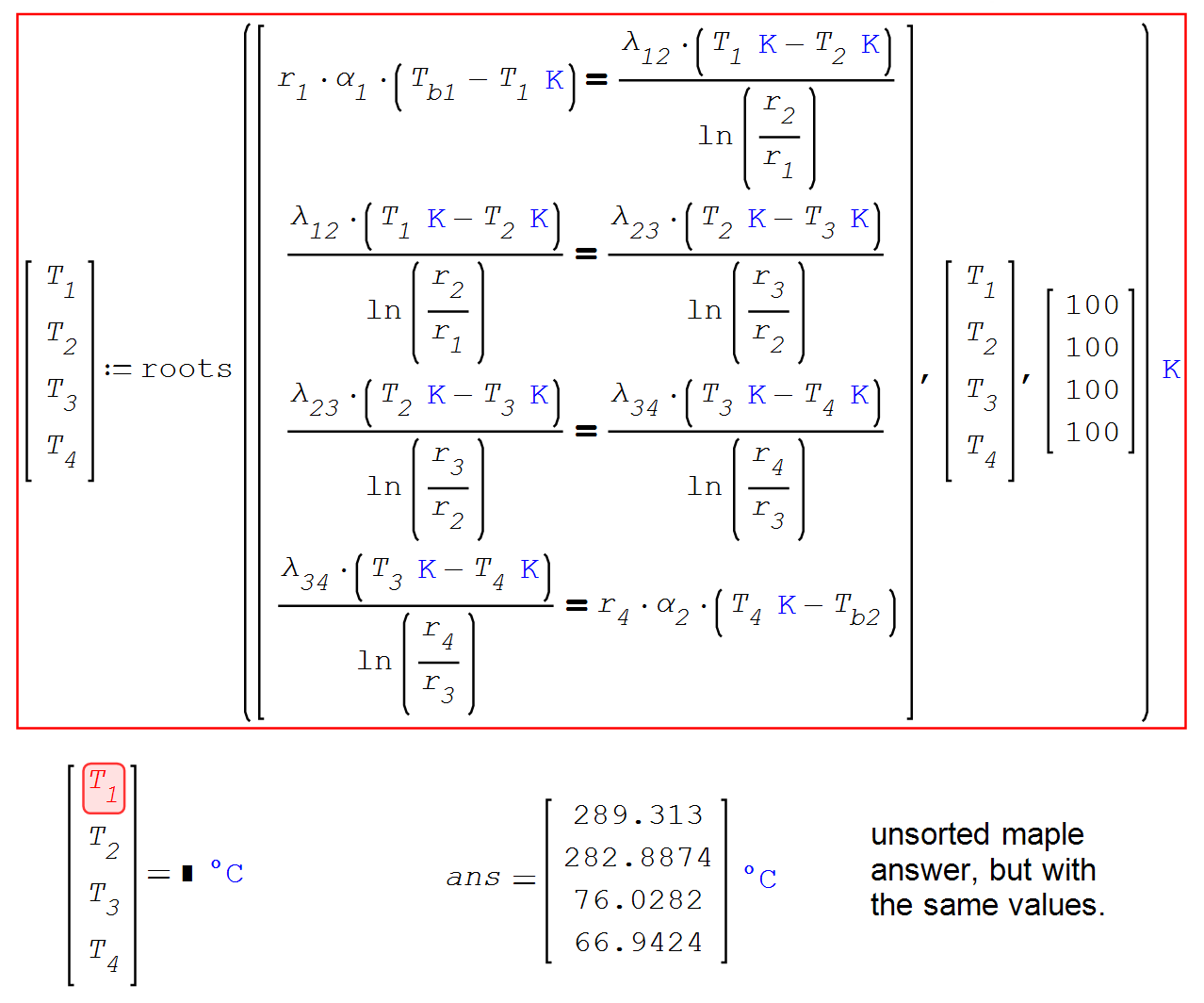

#4 Posted: 7/21/2024 3:52:10 PM
I see Alvaro has beaten me to it, but here's my approach anyway.
Lambda3b.sm (470.18 KiB) downloaded 1445 time(s).
