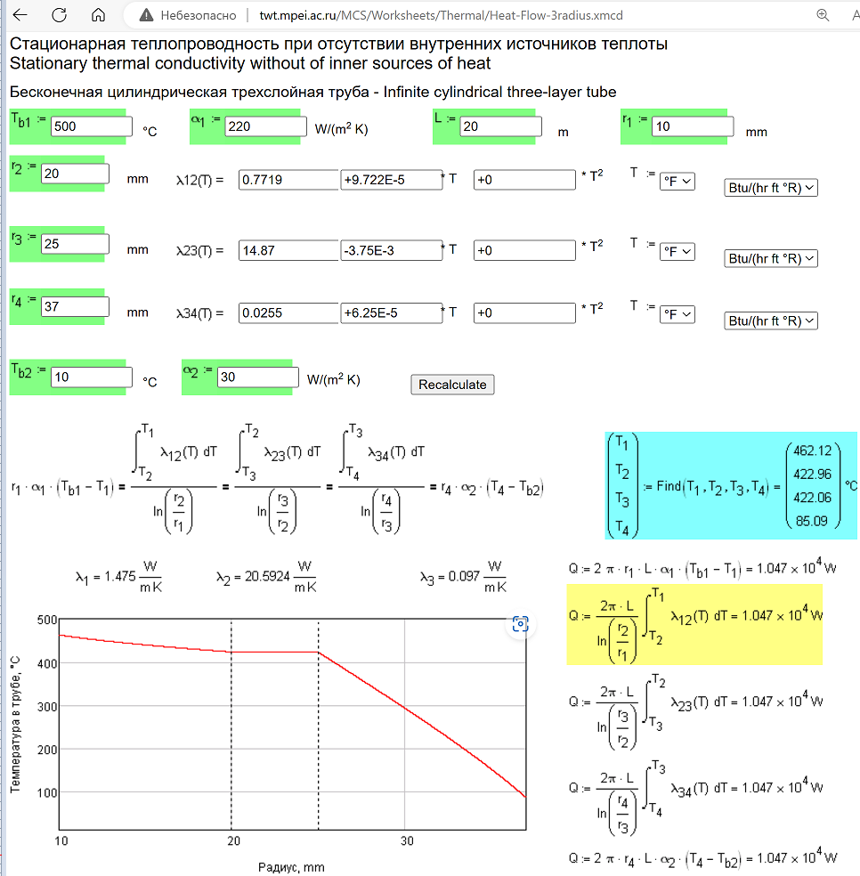

I would like to to sole the linear equations
F1=F2=f3=F4 with 4 unknowns T1, T2, T3 and T4
I can do it in Mathcad (given-find). but cannot in SMath ;-(
Help me please!
See please the Mathcad Calculation Server
http://twt.mpei.ac.ru/MCS/Worksheets/Thermal/Heat-Flow-3radius.xmcd
my SMath try in attach and
Lambda3.sm (434,36 КиБ) скачан 1378 раз(а).
the picture

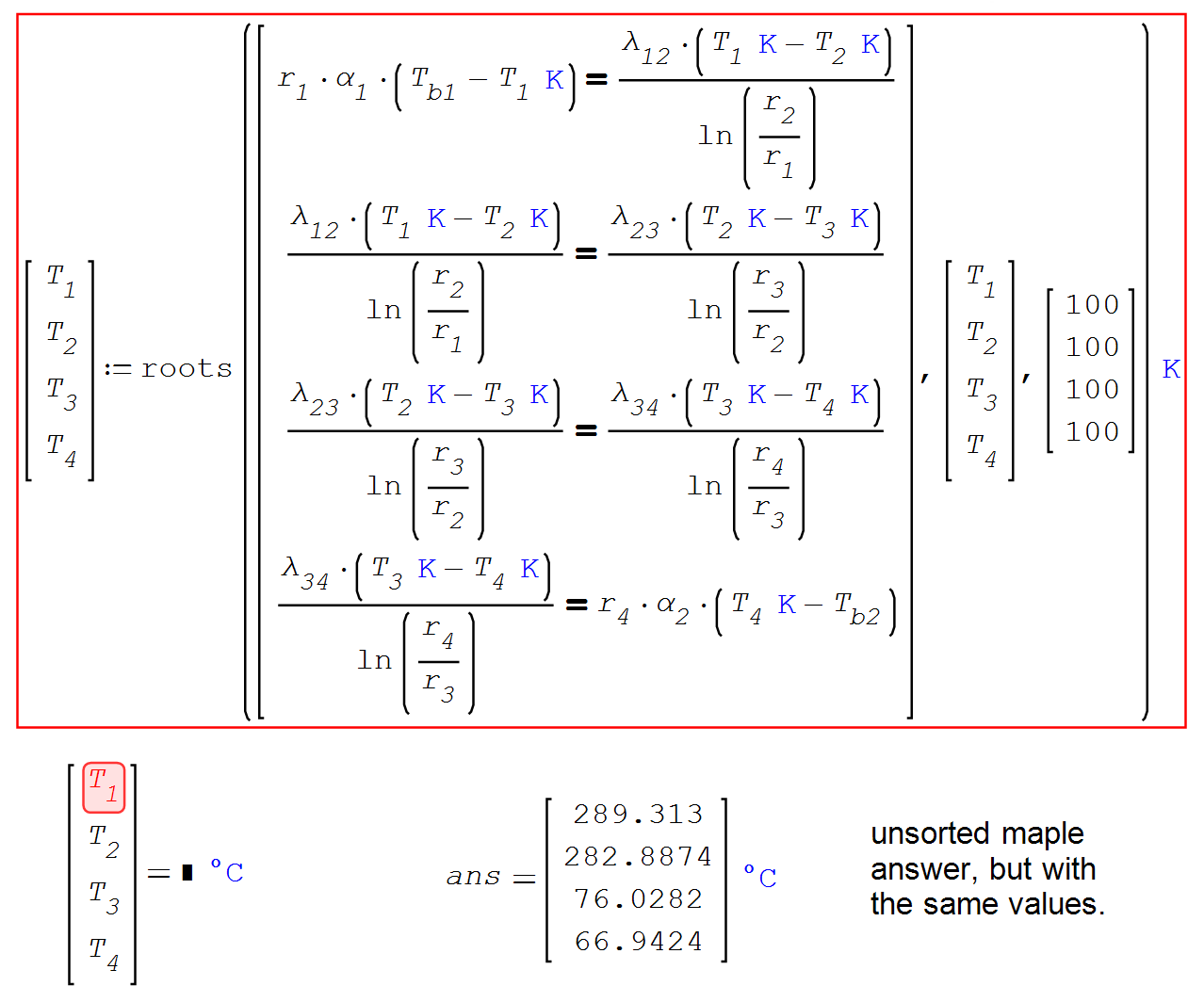

Hi. Here two options for solve the system.
Lambda3.sm (452,05 КиБ) скачан 1392 раз(а).
Valery Ochkov 21.07.2024 15:29:00, ioan92 21.07.2024 17:25:00
Thanks, Alvaro!

I see Alvaro has beaten me to it, but here's my approach anyway.
Lambda3b.sm (470,18 КиБ) скачан 1445 раз(а).
Valery Ochkov 21.07.2024 15:56:00, ioan92 21.07.2024 17:24:00

Thanks to all!
My solution in attach
