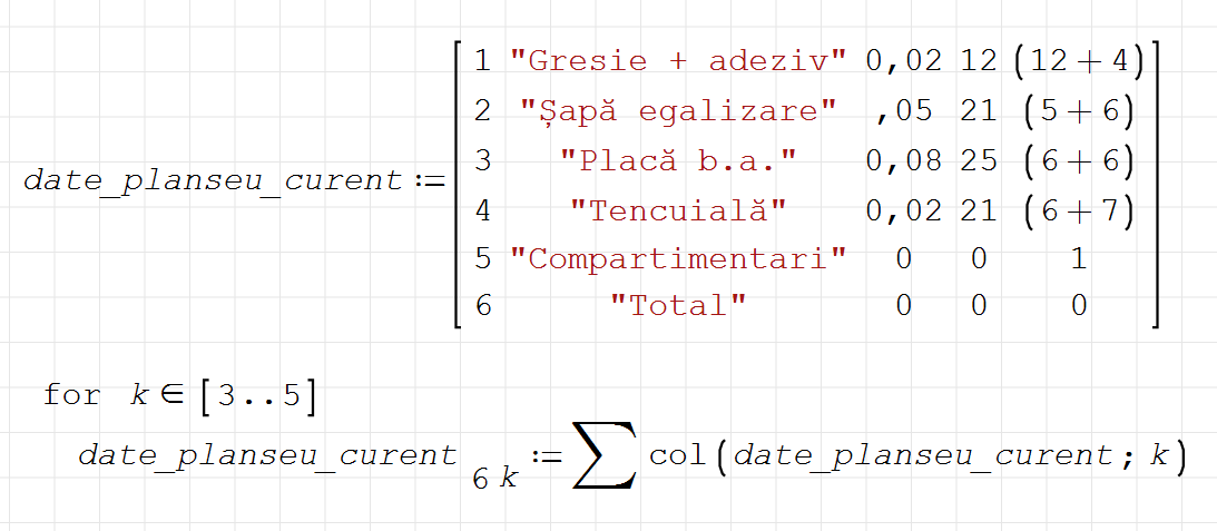

Hello guys,
I have a matrix with system of values in it. I want to sum up all the column.
Could you help me with this?
sumcomplexcolumn.sm (9.96 KiB) downloaded 1303 time(s).

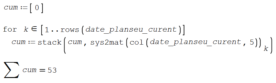

It's necessary convert each system of your 5th column to a matrix by sys2mat() function, then you can stack each matrix from 5th column and do the summation:
sumcomplexcolumn SOLVED.sm (12.77 KiB) downloaded 1283 time(s).
