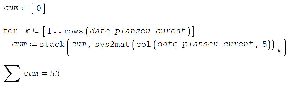

It's necessary convert each system of your 5th column to a matrix by sys2mat() function, then you can stack each matrix from 5th column and do the summation:

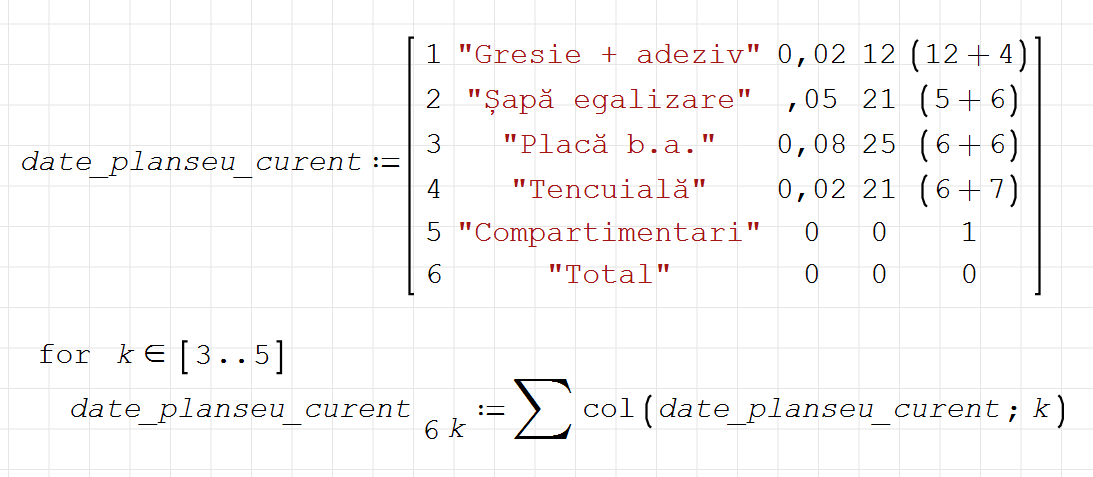

Hi Sergio,
Of course, Oscar’s proposal is a very interesting one
May I make a simple suggestion: avoid the use of “sys” data and replace it with a simple sum, as in my appended file.

If the column's sums are aasked, here is a solution for keeping the answer inside the box...:d
Best Regards,
Ioan
