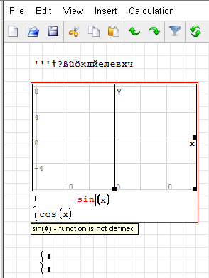

I experience input problems with german keyboard:
- cannot input units (' character does not work)
- I have to input a right (closing) paren in order to get a pair of them.
These problems also appear in smath live and in Knovel interactive equations.
Edit: Rainbow game: Modeler region does not accept input (no mouse response). Moving the modeler region makes it jump to top of the sheet, there seems to be an issue with area regions, if I open the first one, the modeler region jumps inside it and cannot be moved any more.
Edit: F5 just inserts the letter t, the other function buttons are mapped to other regions, F12 creates an empty placeholder.
