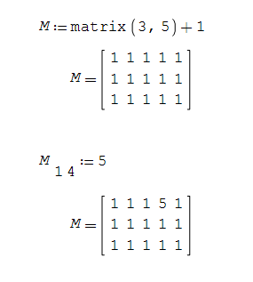

#2 Posted: 9/28/2021 8:14:15 AM
How to add specific element of matrix or table to calculations?
If you have your matrix from calculation,
simply address the element(s) with new value.
#3 Posted: 9/28/2021 8:37:33 AM
1,436 likes in 2,915 posts.

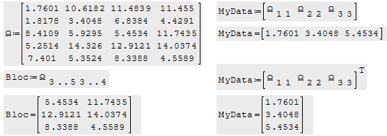

#4 Posted: 9/28/2021 9:17:41 AM
... observe the empty place holder is a / operator.

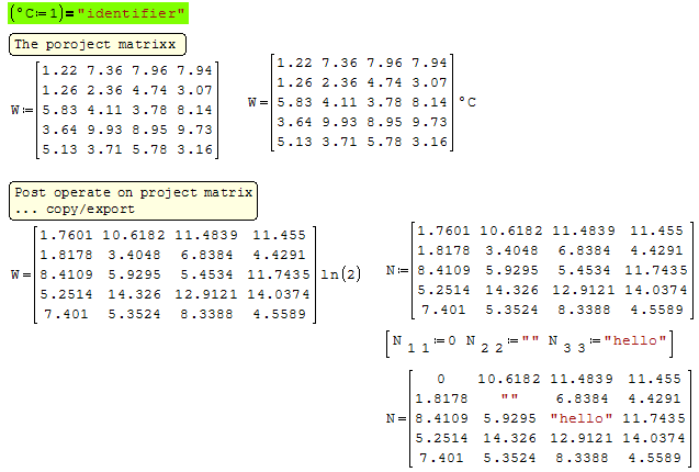

#6 Posted: 9/28/2021 11:15:31 AM
Thank You Jean, but rather, I meant to extract a specific element from the matrix.
There are many more ways ... like skinning a cat.
Cheers ... Jean.

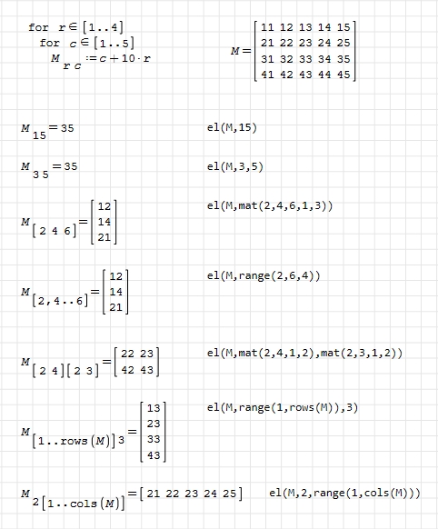

#8 Posted: 9/28/2021 4:21:01 PM
1,080 likes in 1,752 posts.
Hi. There are many different ways to access the elements of an array. This list is not exhaustive, and does not include the submatrix function.
M.sm (10.01 KiB) downloaded 758 time(s).
