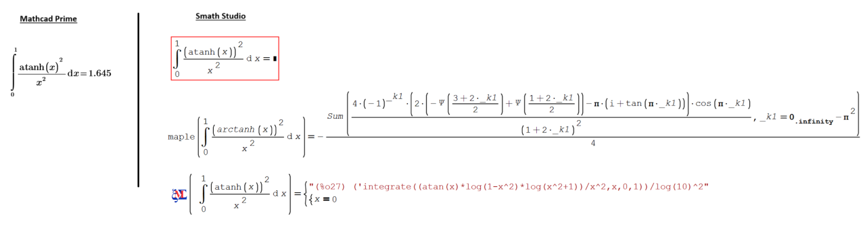

Another integral which Smath cannot solve while Mathcad Prime can:
#2 Posted: 12/26/2024 5:20:48 AM
1,123 likes in 1,795 posts.
Maple provides the exact solution as an infinity sumatorie. Whether that expression is useful or too unwieldy is another question.

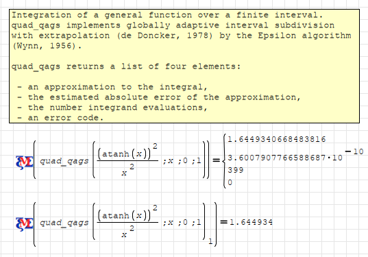

This will be a very late reply, you can even call it necroposting.
But I think it will be useful for some maxima users.
For finite integrals wouldn't be solved easily, use quadpack.
https://maxima.sourceforge.io/docs/manual/Integration.html#Integration
