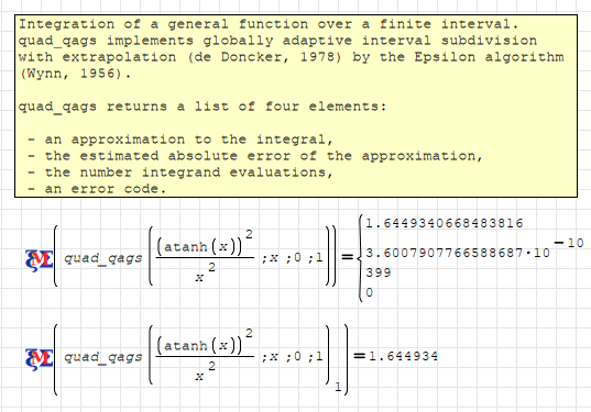

#3 Опубликовано: 22.04.2026 02:46:15
This will be a very late reply, you can even call it necroposting.
But I think it will be useful for some maxima users.
For finite integrals wouldn't be solved easily, use quadpack.
https://maxima.sourceforge.io/docs/manual/Integration.html#Integration
