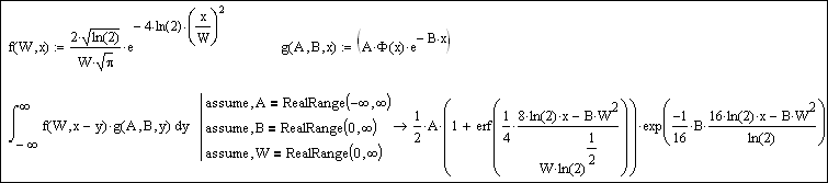

Just confusing it does not evaluate correct Φ(0)=0.5

True: only Mathcad recognizes Heaviside as a function
However, Smath proceeds the convolution integral alright.
