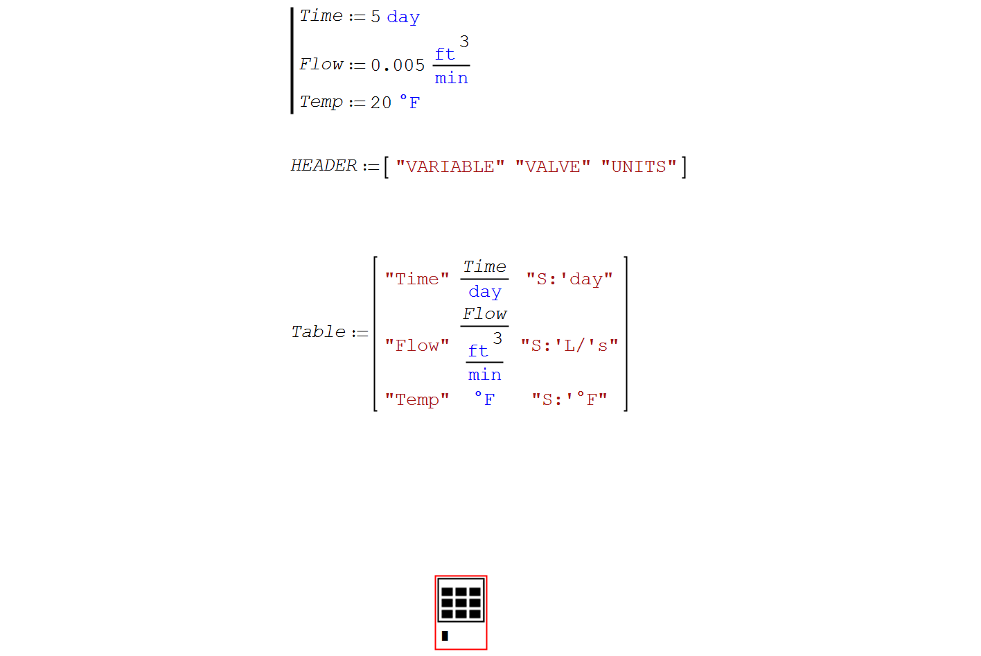

I just inserted a table region into my sheet, but I can't figure out how to change the number of rows or columns, or how to type in it. I select the boxes and a popup that I don't know what to do with pops up.
#2 Posted: 4/23/2019 6:36:03 PM
Table Region Carlos.sm (12.27 KiB) downloaded 1172 time(s).

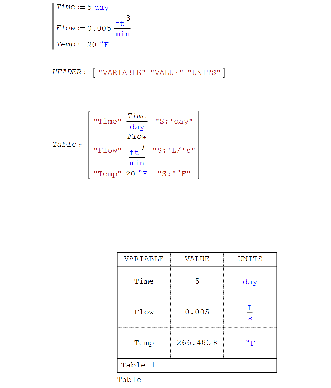

I defined the temp in degrees F, but it put it in degrees K

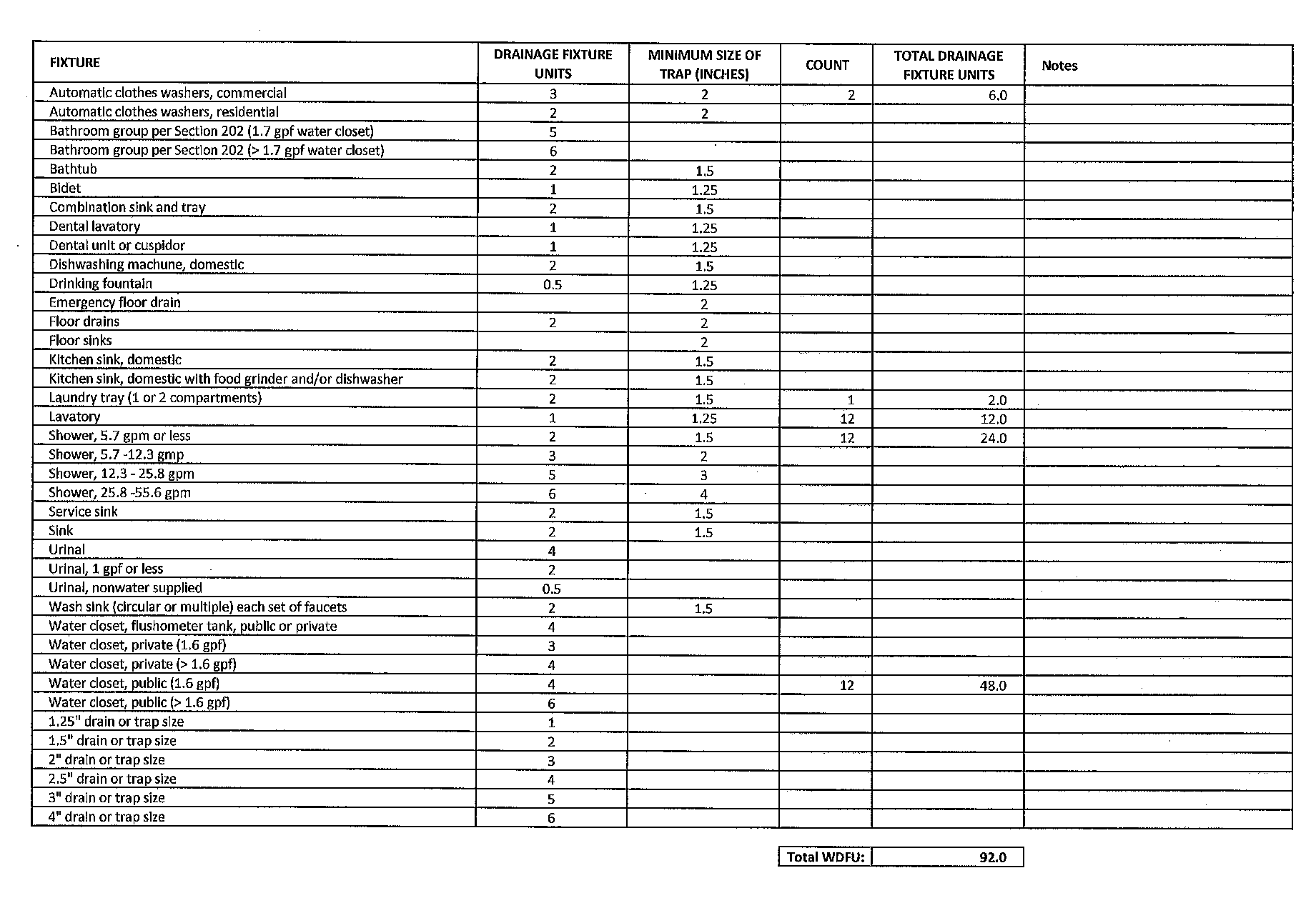

What I want to do is produce a table similar to the image I attached: DFU TABLE.png Also, What does the first definition do for the table? In the example it says
Smath is an advanced CAS. Maybe purchase a tool to list the barn population.
What about Excel, Word ... ?

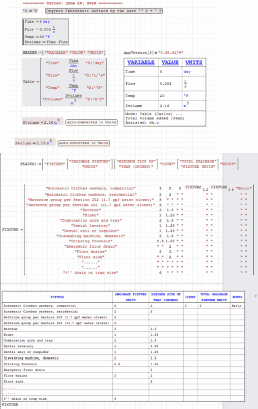

#8 Posted: 4/24/2019 4:57:57 PM
CBG
CBG
78 likes in 312 posts.
Hello
This is a part of your table
Table Region Carlos_R1.sm (28.69 KiB) downloaded 1155 time(s).
Carlos

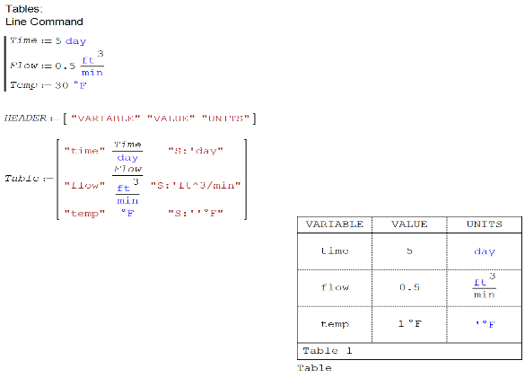

#14 Posted: 5/14/2019 4:32:46 PM
Why does my table say 1 deg F and not 30 ?
Please: attach the document so helpers won't have to redo.

#16 Posted: 5/14/2019 4:38:41 PM
Seems to me that simply you are not using the Temp variable in your Table matrix.

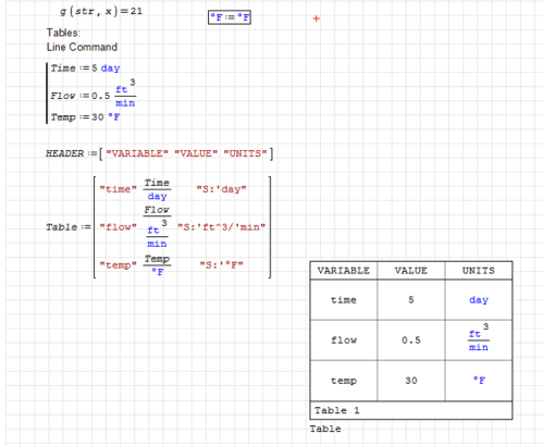

#18 Posted: 5/14/2019 4:52:24 PM
CBG
CBG
test.sm (18.91 KiB) downloaded 1107 time(s).
Here is the correction. It was still necessary to define your own unit of
degrees farenheit to prevent Smath Studio from interpreting it as Kelvin degrees.
On the other hand in the table was missing include the variable Temperature
(temp) divided by the units (° F)
test _Britt1.sm (19.93 KiB) downloaded 1151 time(s).
