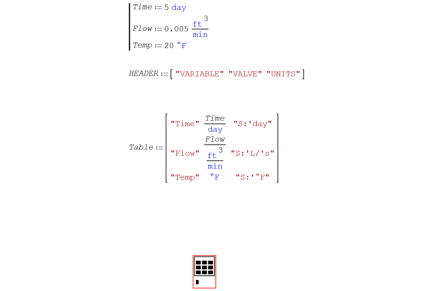

I just inserted a table region into my sheet, but I can't figure out how to change the number of rows or columns, or how to type in it. I select the boxes and a popup that I don't know what to do with pops up.

Once you have inserted the Table from the insert menu,
in that 3 x 3 chess board: type Table in the place holder.
Print Screen, paste in Paint, Select, paste in a tool
that will save as *.PNG [I use WinGrab for over 20 years]

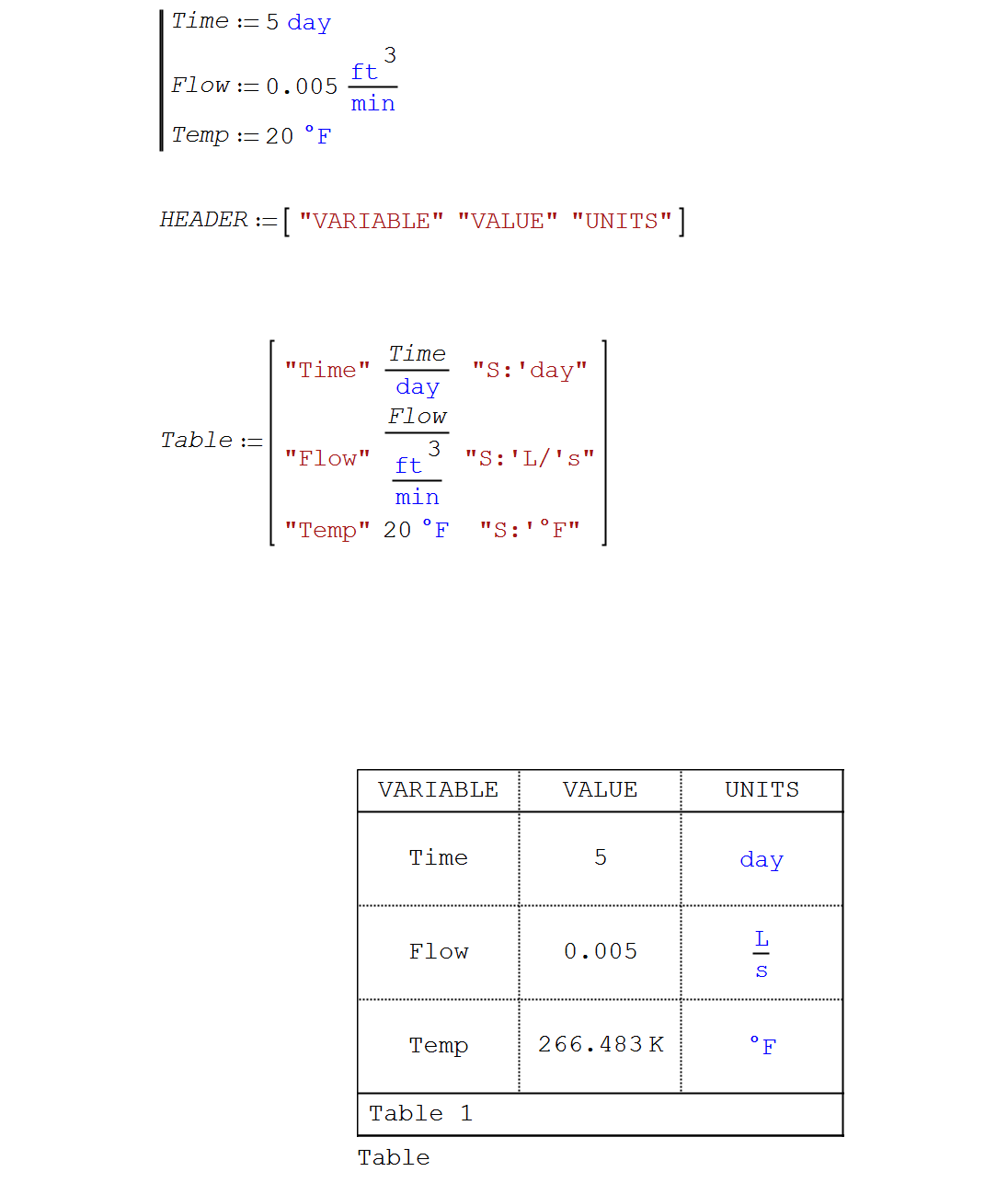

I defined the temp in degrees F, but it put it in degrees K

What I want to do is produce a table similar to the image I attached: DFU TABLE.png Also, What does the first definition do for the table? In the example it says
Time:= 5 day
Flow := 0.005 ft3/min
Temp := 20F

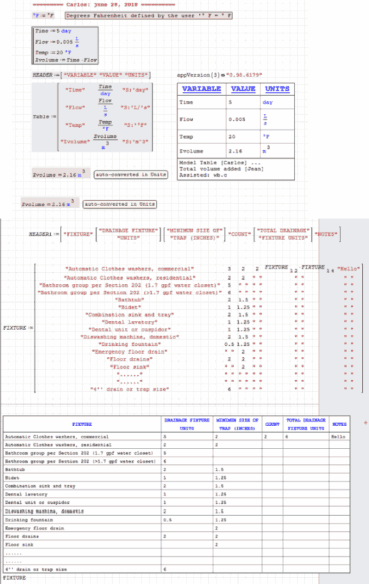

#8 Опубликовано: 24.04.2019 16:57:57
CBG
CBG
Hello
This is a part of your table
Table Region Carlos_R1.sm (28,69 КиБ) скачан 1155 раз(а).
Carlos

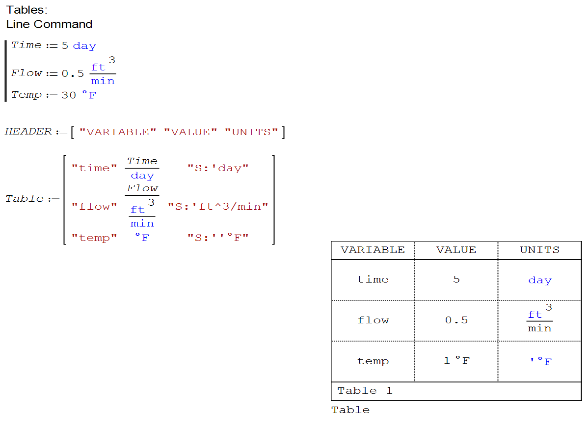

#13 Опубликовано: 14.05.2019 15:43:20
The Cross
The Cross
0 сообщений из 73 понравились пользователям.
#14 Опубликовано: 14.05.2019 16:32:46
Why does my table say 1 deg F and not 30 ?
Please: attach the document so helpers won't have to redo.

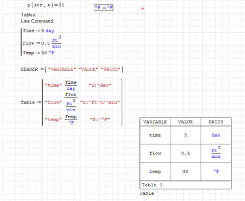

#16 Опубликовано: 14.05.2019 16:38:41
Seems to me that simply you are not using the Temp variable in your Table matrix.
#17 Опубликовано: 14.05.2019 16:44:24
The Cross
The Cross
then, it goes completely crazy and puts in an arbitrary value of 137.79
test.sm (18,99 КиБ) скачан 1151 раз(а).
#18 Опубликовано: 14.05.2019 16:52:24
CBG
CBG
test.sm (18,91 КиБ) скачан 1107 раз(а).
Here is the correction. It was still necessary to define your own unit of
degrees farenheit to prevent Smath Studio from interpreting it as Kelvin degrees.
On the other hand in the table was missing include the variable Temperature
(temp) divided by the units (° F)
test _Britt1.sm (19,93 КиБ) скачан 1151 раз(а).
Carlos
Davide Carpi 14.05.2019 16:59:00
#19 Опубликовано: 14.05.2019 16:57:31
I'd like it was completely arbitrary, I would have created some sort of artificial intelligence
Jokes aside, it is probably the value in the base unit (Kelvin).
I'm sorry but I'm from mobile right now, I can't check it deeply nor provide some example, I hope some of our skilled users can help you more here.
Edit: thank you Carlos
