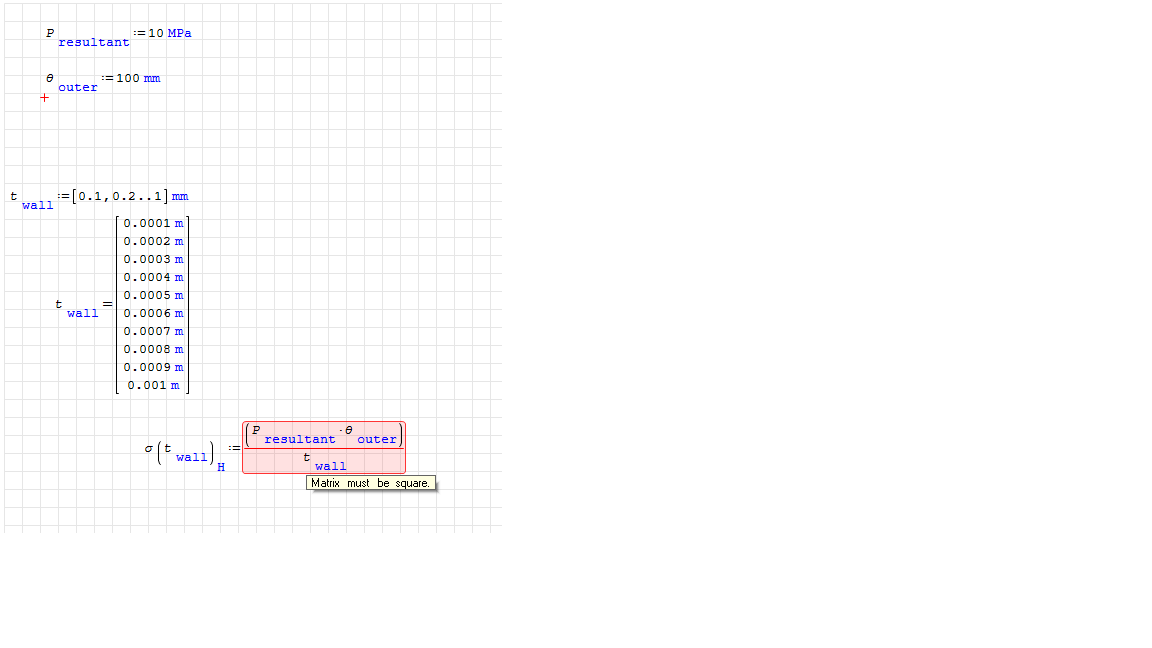

I have looked into vectorizing and tried cross product but I can't figure out how to return a matrix (and eventually a graph) of the function that is a dependent on the variable twall. Any help is appreciated. I'm trying to save money by using this program but it is harder than MathCAD to figure out the errors.

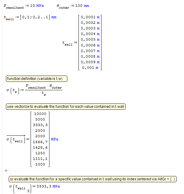

#2 Posted: 7/4/2020 6:24:48 AM
127 likes in 342 posts.
Try like this

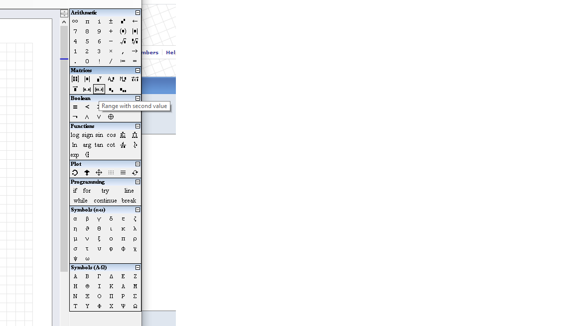

Now I re-found the range operator here:

#7 Posted: 7/4/2020 8:47:23 AM
or type coma select first place holder.

I follow your keystrokes but I get error messages for the function I define and for the vectorized function. Any ideas?
Hi Trip. It seems that you are using matrices subscripts instead dot subscript in the variable t. This make that sigma isn't well defined, and thus can't be vectorized. If you upload your file I'm sure that someone can tell you what's wrong.
#9 Posted: 7/5/2020 2:48:58 PM
If you just want it to work ... Jean
