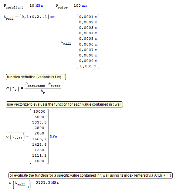

#2 Posted: 7/4/2020 6:24:48 AM
115 likes in 329 posts.
Try like this

So I was able to do for the example but now I can't remember the keystrokes to get:
twall:="0,1;0,2..1"
The part in quotes is where I'm stuck. When I try to type a comma, nothing happens. I can't type 0 and then a comma or 0 and then a semi-colon. I can only type one period. I'm just missing some simple thing to generate what you show.

#4 Posted: 7/4/2020 7:09:19 AM
Use the range function.
Also remember that based on some options related to the set country, they lead to different use of the comma of the period and the semicolon

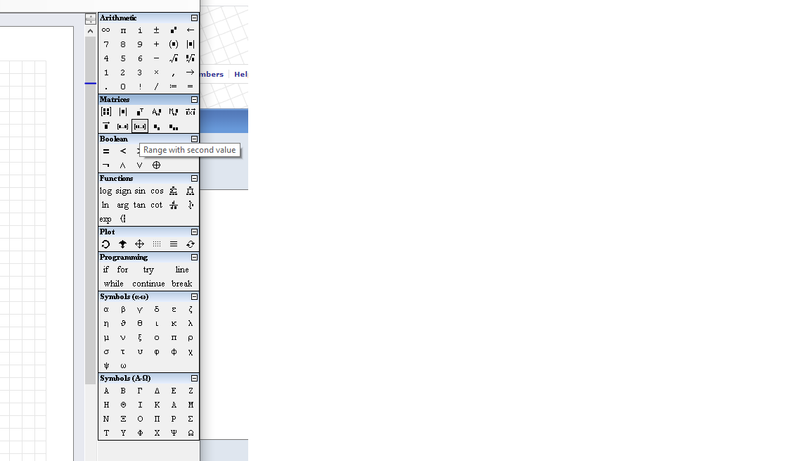

#5 Posted: 7/4/2020 7:10:52 AM
Trip
Trip
0 likes in 4 posts.
Now I re-found the range operator here:

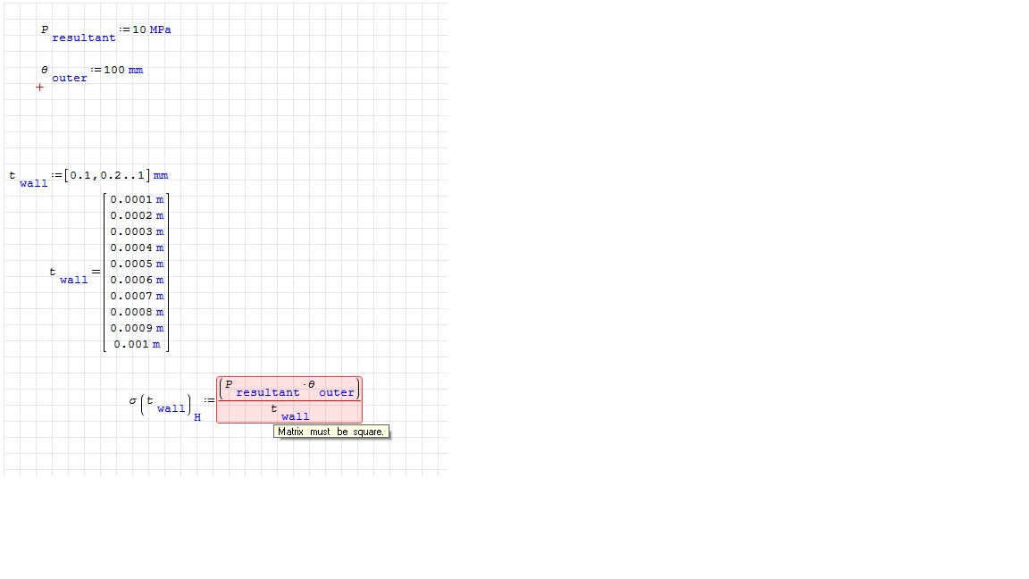

#6 Posted: 7/4/2020 7:23:48 AM
Trip
Trip
0 likes in 4 posts.
I follow your keystrokes but I get error messages for the function I define and for the vectorized function. Any ideas?

#8 Posted: 7/5/2020 12:11:48 PM
Alvaro Diaz Falconi
Alvaro Diaz Falconi
997 likes in 1676 posts.
Hi Trip. It seems that you are using matrices subscripts instead dot subscript in the variable t. This make that sigma isn't well defined, and thus can't be vectorized. If you upload your file I'm sure that someone can tell you what's wrong.
#9 Posted: 7/5/2020 2:48:58 PM
983 likes in 6866 posts.
If you just want it to work ... Jean
rangeUNK.sm (8 KiB) downloaded 247 time(s).
