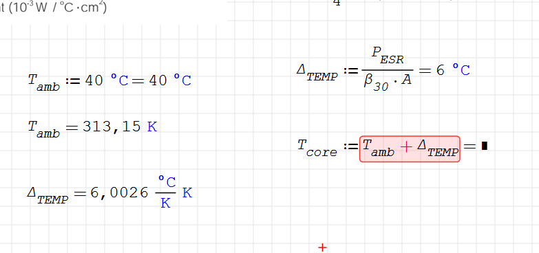

#8 Posted: 9/28/2019 7:17:24 PM
Hello, I would like to consult you
I define a temperature in degrees Centigrade, when I call it it looks like Kelvin degrees and then I can't make a sum because it tells me they are two different units. How can I do so that the defined temperature is maintained in every calculation in the unit that defined it?
Attached image capture of the problem.
Thank you
Thank you

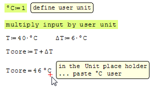

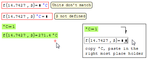

#9 Posted: 9/29/2019 4:22:37 AM
There are many posts on the Forum about handling tempereture units. See for example this one.

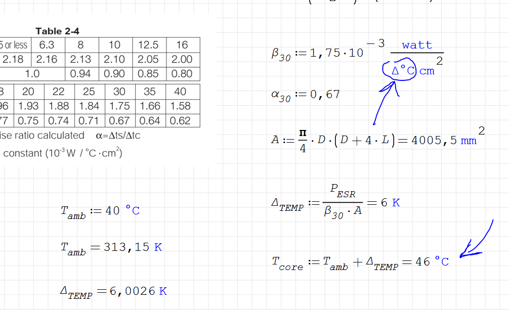

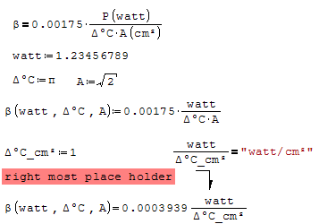

#11 Posted: 9/29/2019 9:37:54 AM
Visit Colebrook, suggestive how to carry Engineering projects.
And recover units in the results. Each project is specific.
Please, feel free to attach your project for more doctoring.
