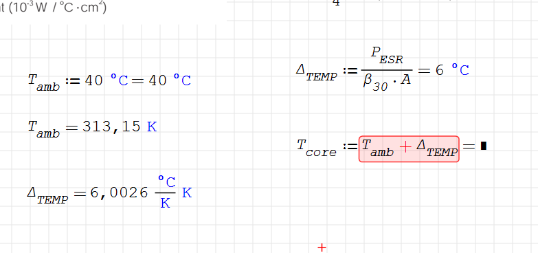

Hello, I would like to consult you
                                                I define a temperature in degrees Centigrade, when I call it it looks like Kelvin degrees and then I can't make a sum because it tells me they are two different units. How can I do so that the defined temperature is maintained in every calculation in the unit that defined it?
Attached image capture of the problem.
Thank you

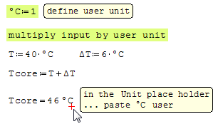

There are many posts on the Forum about handling tempereture units. See for example this one.
frapuano 29.09.2019 08:28:00

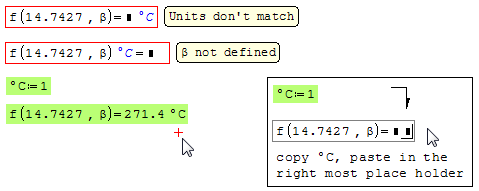

#10 Опубликовано: 29.09.2019 07:46:27
Smath Unit System is ISO, °C is not ISO.
Define your user unit.
If user unit is not '1', don't multiply input by user.

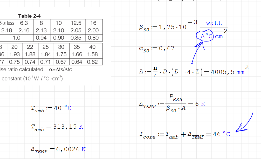

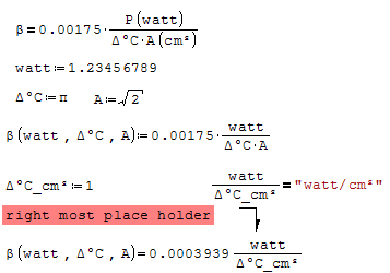

#11 Опубликовано: 29.09.2019 09:37:54
Visit Colebrook, suggestive how to carry Engineering projects.
And recover units in the results. Each project is specific.
Please, feel free to attach your project for more doctoring.
Inst_Colebrook Pipe Data.sm (61,76 КиБ) скачан 739 раз(а).
