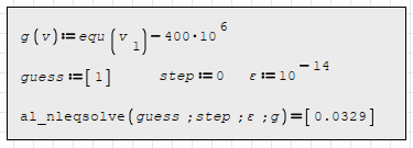

In times of these, al_nleqsolve() is your friend.
Or you can use maple or maxima solvers.
NoRealRootsError_solved.sm (8.97 KiB) downloaded 1167 time(s).
Hi overlord, thanks for your help.
Could you elaborate on what is described in the grey area?
Why did you re-write the equation to f(d)? And why is in the equation f(d) equ(d) added?
What is the function of step:=0?

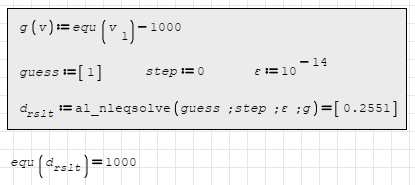

step is max solving steps of al_nleqsolve(), zero means unlimited steps.
guess is a starting point for variable. eps is tolerance for solver.
You can read more about al_nleqsolve() function from Reference Book.
f(d) is common usage of function, not necessary.
Just added for correspondence for functions help sheet.
Can be written as this too, but g(v)=f(v1) is necessary.

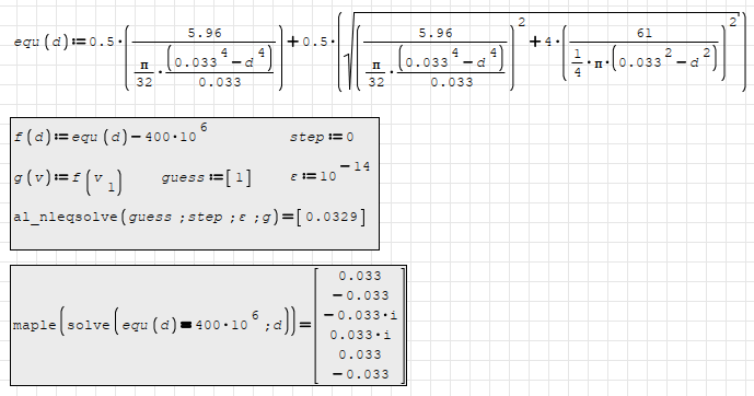

Sorry, coming back on this. What is the meaning of 0.033*i? I can't see what in the end is the solution to d?
i means imaginary number if (-1)^(1/2).
Fourth power of all solutions of d makes function zero.
NaN actually in your case, division by zero.
But numeric solver takes this as a result I guess.

Maple collects all possible solutions, including pure imaginary.
Best respond is the solve(,,,,) bloc, just real intersections.

Thanks for your explanation, some things are strange to me a bit:
1. How can I setup such a grey block as you did?
2. eps should be the tolerance for the solver, I change it to for example to 10 (instead of 14), but the outcome didn't change anyway?
3. Why isn't the jacobi matrix used in the al_nleqsolve()?
4. What does g(v):=f(v1) mean?

I can't follow along with the maple(solve) function yet, why does it end up with 6 values?
It is just an empty text region placed under the equations. Check the file NoRealRootsError_solved_v2.sm (14.01 KiB) downloaded 1158 time(s)..
It relates decimal accuracy, 10^14 means it will numerically check solvers epsilon till it won't change for 10^14 digits.
Sometimes you need Jacobian matrix sometimes you don't.
It is how it is used in al_nleqsolve(). v is gathered from guess matrix. v1 is first element of guess matrix.
If a system of two unknown would be solved than it will be used as in Reference Book.
5. Where is the value of 1000 based on in this equation? I doesn't see the reference?
1000 is used instead of your 400*10^6, just to show solver is finding results correctly.
6. I can't follow along with the maple(solve) function yet, why does it end up with 6 values?
maple plugin is more capable than SMath's other functions at certain areas, sometimes it can find more results.
It is much more reliable at symbolic results for example.

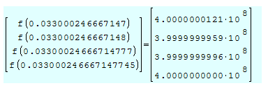

#15 Posted: 8/28/2022 10:19:22 AM
Thanks Alvaro.
You are the Grand Doctor in Smath Community.
So much maths involved ... 10 decimals !!!
Hola ... Jean.

#17 Posted: 8/28/2022 12:42:46 PM
Thanks button does not work for ~ 8 years.
You won't get more decimals than snippet above, 10 D.
Too many numerical maths involved.
Cheers ... Jean.
