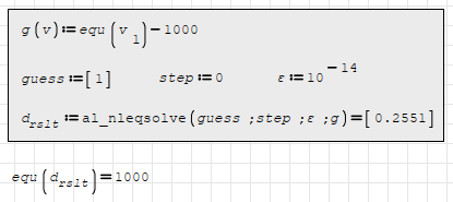

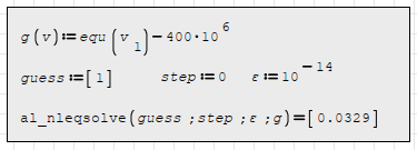

Hi overlord, thanks for your help.
Could you elaborate on what is described in the grey area?
Why did you re-write the equation to f(d)? And why is in the equation f(d) equ(d) added?
What is the function of step:=0?

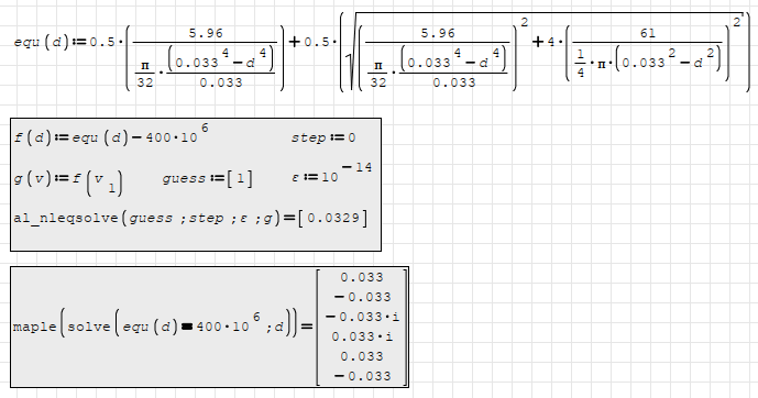

Sorry, coming back on this. What is the meaning of 0.033*i? I can't see what in the end is the solution to d?
step is max solving steps of al_nleqsolve(), zero means unlimited steps.
guess is a starting point for variable. eps is tolerance for solver.
You can read more about al_nleqsolve() function from Reference Book.
f(d) is common usage of function, not necessary.
Just added for correspondence for functions help sheet.
Can be written as this too, but g(v)=f(v1) is necessary.
i means imaginary number if (-1)^(1/2).
Fourth power of all solutions of d makes function zero.
NaN actually in your case, division by zero.
But numeric solver takes this as a result I guess.
What is the meaning of 0.033*i ?
Maple collects all possible solutions, including pure imaginary.
Best respond is the solve(,,,,) bloc, just real intersections.

I can't follow along with the maple(solve) function yet, why does it end up with 6 values?

Thanks for your explanation, some things are strange to me a bit:
1. How can I setup such a grey block as you did?
It is just an empty text region placed under the equations. Check the file NoRealRootsError_solved_v2.sm (14,01 КиБ) скачан 1158 раз(а)..
2. eps should be the tolerance for the solver, I change it to for example to 10 (instead of 14), but the outcome didn't change anyway?
It relates decimal accuracy, 10^14 means it will numerically check solvers epsilon till it won't change for 10^14 digits.
3. Why isn't the jacobi matrix used in the al_nleqsolve()?
Sometimes you need Jacobian matrix sometimes you don't.
4. What does g(v):=f(v1) mean?
It is how it is used in al_nleqsolve(). v is gathered from guess matrix. v1 is first element of guess matrix.
If a system of two unknown would be solved than it will be used as in Reference Book.
5. Where is the value of 1000 based on in this equation? I doesn't see the reference?
1000 is used instead of your 400*10^6, just to show solver is finding results correctly.
6. I can't follow along with the maple(solve) function yet, why does it end up with 6 values?
maple plugin is more capable than SMath's other functions at certain areas, sometimes it can find more results.
It is much more reliable at symbolic results for example.

#19 Опубликовано: 28.08.2022 14:09:08
From the latest files, some questions:
2. What's meant with "finding roots"? Why do I need to find roots? (@overlord)
root of a function is what it makes 0 when given to unknown.
for example; take f(x)=x^2+3*x+2.
f(x) results zero when x is equal to -2 and -1.
solve(), roots(), FindRoot(), al_nleqsolve() are simply trying to find that zero makers.
main purpose of solvers are trying to find the root of given function.
3. What is the reason this function is used? What does that 0.2551 value say to me?
this function finds x value which makes equ(x) is equal to 1000.
solve(), roots(), FindRoots() etc could be used too.
I used it just to show you smath can solve your function, correctly.
