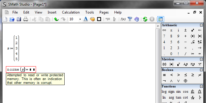

I've tried using the "norme" function -- the function that calculates the Euclidean norm of a vector (or matrix) -- and can't get it to work. For example, when I try:
s:mat(1,2,3,4,5,5,1)
norme(s)=
It won't calculate the Euclidean norm. Instead I get this strange message:
Attempted to read or write protected memory. This is often an indication that other memory is corrupt.
Not a big deal, since you can define your own "norme" function, e.g.,
NormE(F):line(nn:length(F),sqrt(sum((el(F,k)^2),k,1,nn)),2,1)
but, if it's listed in the "function" collection, it'd be nice to have it working properly.

#2 Posted: 9/2/2012 4:54:36 PM
That is strange...
The norme() does not work on the laptop with Win7 "error: Atempted to read or write protected memory..." - but it does works at the desktop with WinXP.
[MATH=eng]s:mat(1,2,3,4,5,5,1)[/MATH]
[MATH=eng]norme(s)=7.4162[/MATH]

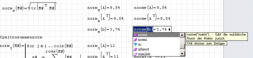

#4 Posted: 5/17/2013 9:29:55 AM
enorm() seems to work now (with 0.96.4884). The workaround from the customFunctions plugin is switched off here, as the dynamic assistant (invoked by F12) shows.
#5 Posted: 5/17/2013 10:03:03 AM
Good, I'll disable the customFunctions workaround
