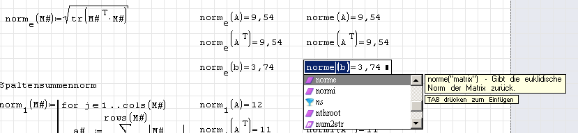

enorm() seems to work now (with 0.96.4884). The workaround from the customFunctions plugin is switched off here, as the dynamic assistant (invoked by F12) shows.
#5 Опубликовано: 17.05.2013 10:03:03
Good, I'll disable the customFunctions workaround
