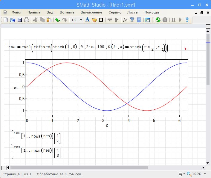

#70 Posted: 7/19/2018 7:45:36 AM
1,555 likes in 1,867 posts.
Updated. Skip intel ode assembly loading if Linux used. So in Linux only 2 functions available: rkfixed() and Rkadapt().
Raspbian on RaspberryPi 3.

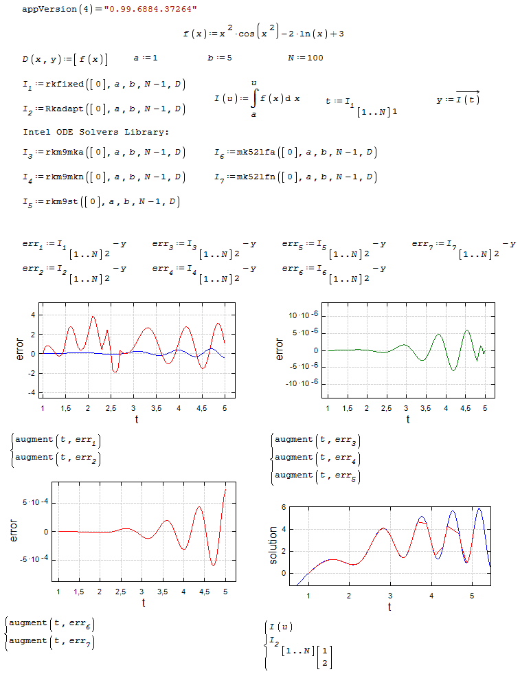

Simple intel ode test 2.
iode.test2.sm (22.5 KiB) downloaded 2162 time(s).
iode.test2.pdf (121.64 KiB) downloaded 1042 time(s).
sergio 8/1/2018 6:06:00 PM

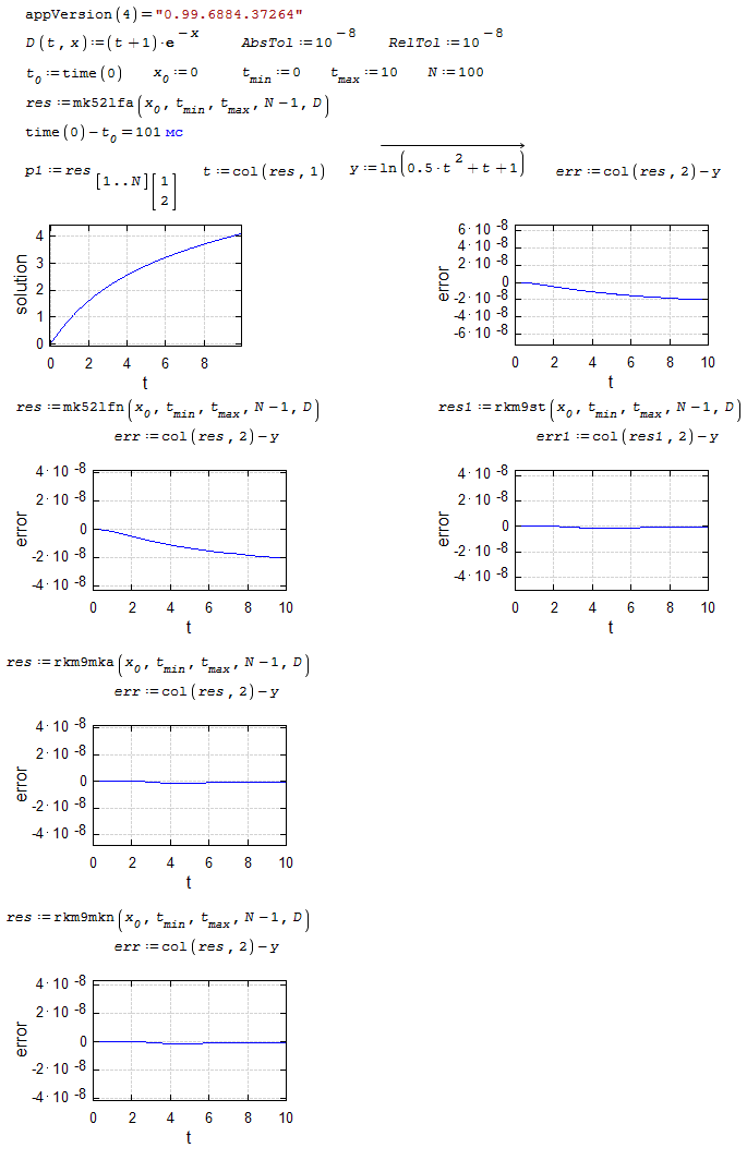

#72 Posted: 12/3/2018 5:21:26 PM
Updated. Fixed issue with zero point.

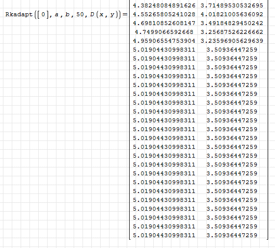

ODE test 3. Something wrong with Rkadapt().
iode.test3.sm (24.09 KiB) downloaded 1668 time(s).
iode.test3.pdf (112.7 KiB) downloaded 880 time(s).
Alvaro 12/3/2018 10:25:00 PM
#73 Posted: 12/3/2018 11:32:02 PM
Hi Viacheslav. It seems that for Rkadapt t repeats itself, at least for low N values. Maybe you can handle that with some if abs(t[n+1]-t[n])<(some tol) then do something for modify t, and not add it to the final solution. Probably it could be because your step size goes too short.

#76 Posted: 12/4/2018 9:55:44 AM
It looks OK to me from Rkadapt design.
It reaches solution in 42 steps vs fixed 100.
iode.test3 Strip Rkadapt.sm (11.15 KiB) downloaded 1667 time(s).
#77 Posted: 12/4/2018 10:17:01 AM
... In fact: Rkadapt reaches solution in 35 steps.
MCD Rkadapt results in equally spaced solutions.
MCD rkadapt comes with two extra parameters
"acc" accuracy
"s" step size
As it looks Smath Rkadapt muffs the start,
Try 34/35 => observe the result.
iode.test3 Strip Rkadapt.sm (16.85 KiB) downloaded 1704 time(s).
