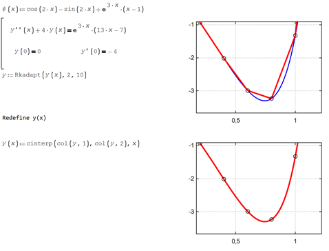

#102 Posted: 11/30/2021 9:58:24 AM
With enough points, simply cinterp Smath.
ODE HIRES.sm (67.25 KiB) downloaded 1655 time(s).

Full set: interp(), [l,p,c]spline().
Click to enlarge
Odesolve interpolation test.sm (59.06 KiB) downloaded 1634 time(s).
Odesolve interpolation test.pdf (102.91 KiB) downloaded 1003 time(s).
(*) rkfixed() with a bug now, so you will see something differ.

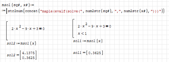

This looks very interesting. Seems that it is not yet in the online gallery?
In principle, the built-in diff(1) operator would be an option but it looks ugly if applied twice.
The ordinary prime would be ok for me (just as it is used as tag in unit names), it is input as Shift # on german keyboards.
diff2.sm (2.79 KiB) downloaded 1614 time(s).

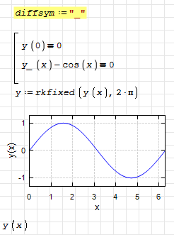

I've made some changes. I liked the idea with the str2num() function. Also I can override the diff(1) function, but that can be confusing.
Now it is possible to numerically solve the Cauchy problem for one variable: diff(y(x),x,n)=F(x,y(x),...,diff(y(x),x,n-1)) . Later, I will expand the rest of the ODE solvers to support this simplified form. But for this I need to combine plugins and add interpolation functions similar to Mathcad (lspline(), interp(), ...). It will be more convenient for me to test the solvers, comparing the results with Mathcad.
Block region collects equations in the form of a system and substitutes it as the first parameter into the function.

- default diff symbol is apostrophe ( ' );

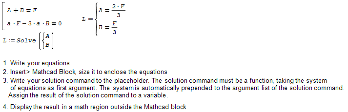

This is how to use it with symbolic solutions using Solve() (Maxima plugin):
Solve block.sm (5.37 KiB) downloaded 1659 time(s).

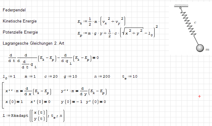

Looking forward to a RK integrator for multi-DOF systems. This is how I would imagine the user interface.
Federpendel-block.sm (48.39 KiB) downloaded 1659 time(s).
This is the next step, but the existing solution is not stable and has some bugs.

Hi. In the meantime, we can play with things like this:
Solve block.sm (54.97 KiB) downloaded 1711 time(s).
