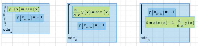

BTW, how about making the glyph of the mathcad block reflect the actual type by using {,[ or | to indicate the vertical extension?
I haven't done this yet because I want the user to be able to choose the type of lines. For all sides.

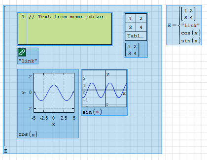

Theoretically, I can get data from any component. I can try to get the text from the text region.
Alvaro 4/29/2023 8:26:00 AM
#165 Posted: 4/29/2023 8:31:27 AM
Theoretically, I can get data from any component. I can try to get the text from the text region....
Amazing: That's true for a lot of components! What about to catch the text in your memo editor instead SMath's text regions? Or both, I don't know.
#166 Posted: 4/29/2023 8:52:55 AM
1,555 likes in 1,867 posts.
It's funny, I haven't tried it. I want to simplify the input of text programs. This is another way to extend the functionality of the program through third-party libraries.
A lot of useful libraries have been developed now. There is no point in repeating all this. It is necessary to create flexible interfaces for their integration and interaction with each other.

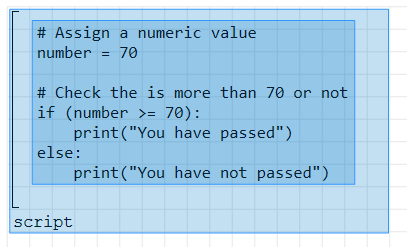

Changes:
- MathcadBlock: added support for TextRegion.
Click to enlarge
maple-system-python-TextRegion.sm (5.58 KiB) downloaded 1597 time(s).

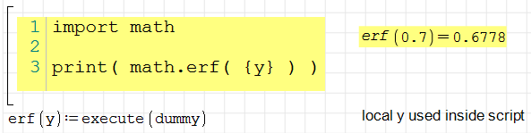

#169 Posted: 4/30/2023 1:14:56 PM
SMath Studio compatibility
Plugin updated.
Changes:
- MathcadBlock: added support for function definition.
Now the function definition can be written directly in the block.
Click to enlarge
maple-system-execute.sm (8.08 KiB) downloaded 1670 time(s).
Memo Region also supported but it has not been updated for a long time, so some of its text functions do not work.

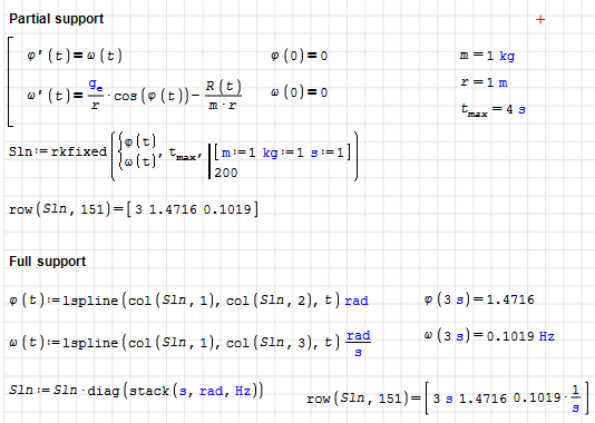

#170 Posted: 11/25/2023 8:25:40 AM

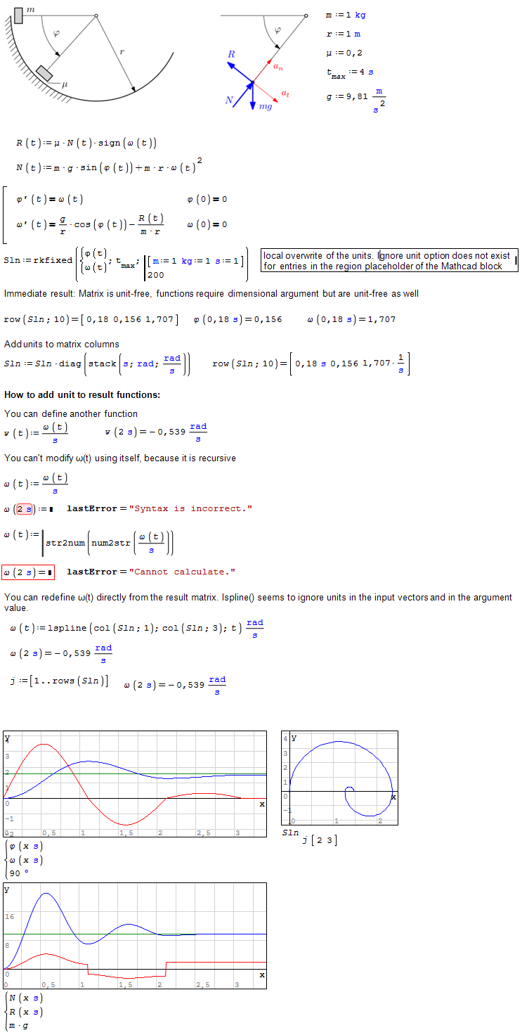

Is there a chance to at least partially use units here? The values with units are disabled in the sheet, this is not visible in the png-file.
7-1.sm (29.01 KiB) downloaded 1640 time(s).
sergio 11/25/2023 7:38:00 PM
#171 Posted: 11/25/2023 1:26:55 PM
This is an option for having partial and full units support.
7-1-units.sm (35.56 KiB) downloaded 1615 time(s).
sergio 11/25/2023 7:38:00 PM, Martin Kraska 11/25/2023 7:45:00 PM
#172 Posted: 11/25/2023 7:44:24 PM
Alvaro, thanks for the hints.
By whatever reason, the unit of the independent variable is respected in rkfixed()=even though it is set to 1 locally. Whatever locally means if that happens in the last input parameter value.
7-1_units.sm (39.68 KiB) downloaded 1645 time(s).

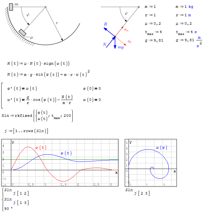

#173 Posted: 5/15/2024 4:41:22 AM
Hi Viacheslav. It seems that there is some issue with Rkadapt and fixed that other solvers doesn't have.
dint - Rkadapt bug.sm (24.83 KiB) downloaded 1674 time(s).
ioan92 5/15/2024 7:12:00 PM, Вячеслав Мезенцев 5/17/2024 2:00:00 AM

Using ode solvers for evaluate double integrals.
dint-RK.sm (49.38 KiB) downloaded 1681 time(s).
dint-RK.pdf (197.5 KiB) downloaded 1191 time(s).

I select the type of bracket for different modes of operation of the block. There are problems with drawing the system sign.

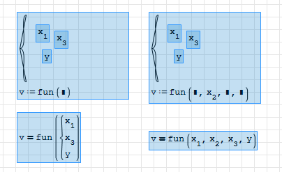

I think it would be fun to add the ability to tell the component where to insert a set of expressions: as the first parameter, as the last parameter, as parameters, as parameters before specified, after specified.
Or to indicate where to place them.
