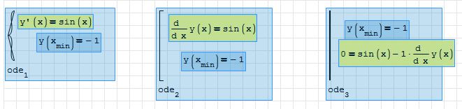

Draghilev's method for the Solve Block.
DraghilevSolveBlock.sm (549,05 КиБ) скачан 1776 раз(а).
DraghilevSolveBlock.pdf (1,42 МиБ) скачан 1120 раз(а).
#162 Опубликовано: 18.04.2023 03:26:27
BTW, how about making the glyph of the mathcad block reflect the actual type by using {,[ or | to indicate the vertical extension?
I haven't done this yet because I want the user to be able to choose the type of lines. For all sides.

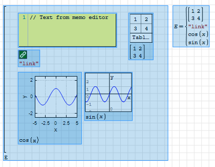

Alvaro 29.04.2023 08:26:00
#165 Опубликовано: 29.04.2023 08:31:27
Theoretically, I can get data from any component. I can try to get the text from the text region....
Amazing: That's true for a lot of components! What about to catch the text in your memo editor instead SMath's text regions? Or both, I don't know.
#166 Опубликовано: 29.04.2023 08:52:55
It's funny, I haven't tried it. I want to simplify the input of text programs. This is another way to extend the functionality of the program through third-party libraries.
A lot of useful libraries have been developed now. There is no point in repeating all this. It is necessary to create flexible interfaces for their integration and interaction with each other.
Alvaro 29.04.2023 09:32:00
#167 Опубликовано: 29.04.2023 09:39:33
... I want to simplify the input of text programs. ...
Yep. It would be very practical to have a tool to capture text to process it. I try to use description() function, but it has the drawback that it must be called at the worksheet level and it doesn't work well within the body of a function. Like in chess, RPN, Code or XYOptions.

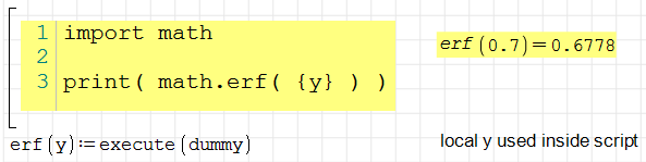

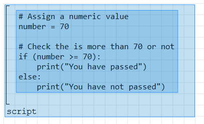

Plugin updated.
Changes:
- MathcadBlock: added support for TextRegion.
Click to enlarge
maple-system-python-TextRegion.sm (5,58 КиБ) скачан 1597 раз(а).
sergio 30.04.2023 12:37:00, Alvaro 30.04.2023 13:25:00
#169 Опубликовано: 30.04.2023 13:14:56
SMath Studio compatibility
Plugin updated.
Changes:
- MathcadBlock: added support for function definition.
Now the function definition can be written directly in the block.
Click to enlarge
maple-system-execute.sm (8,08 КиБ) скачан 1670 раз(а).
Memo Region also supported but it has not been updated for a long time, so some of its text functions do not work.

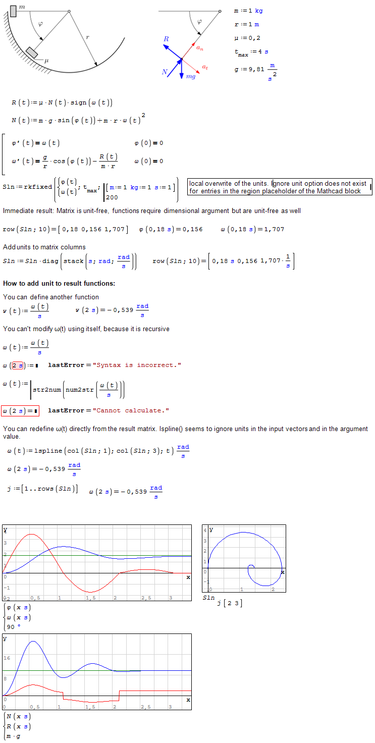

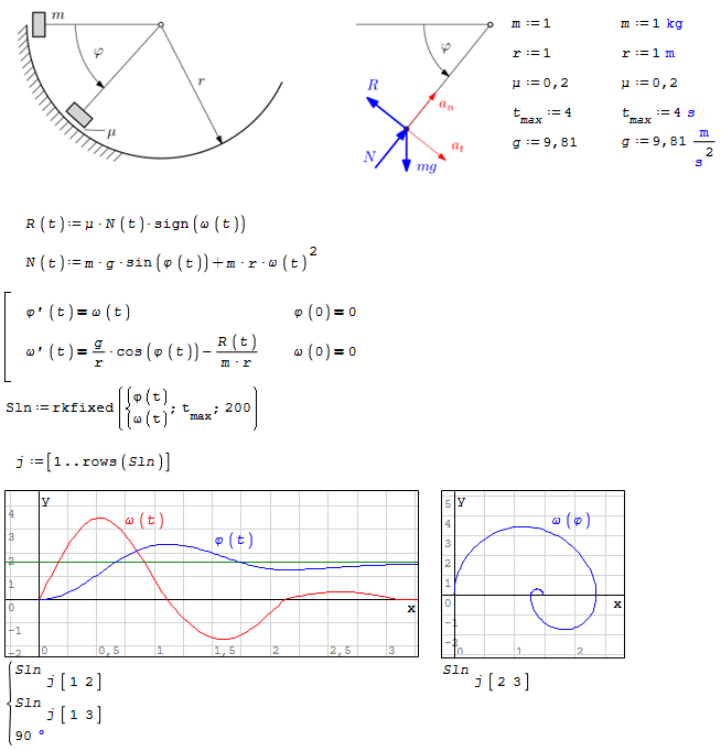

#170 Опубликовано: 25.11.2023 08:25:40
Is there a chance to at least partially use units here? The values with units are disabled in the sheet, this is not visible in the png-file.
7-1.sm (29,01 КиБ) скачан 1640 раз(а).
sergio 25.11.2023 19:38:00

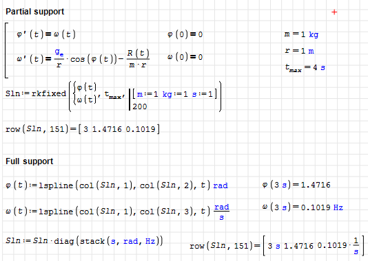

#171 Опубликовано: 25.11.2023 13:26:55
This is an option for having partial and full units support.
7-1-units.sm (35,56 КиБ) скачан 1617 раз(а).
sergio 25.11.2023 19:38:00, Martin Kraska 25.11.2023 19:45:00
#172 Опубликовано: 25.11.2023 19:44:24
Alvaro, thanks for the hints.
By whatever reason, the unit of the independent variable is respected in rkfixed()=even though it is set to 1 locally. Whatever locally means if that happens in the last input parameter value.
7-1_units.sm (39,68 КиБ) скачан 1645 раз(а).

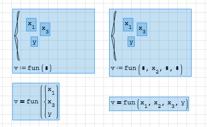

#179 Опубликовано: 05.10.2024 05:49:09
I select the type of bracket for different modes of operation of the block. There are problems with drawing the system sign.
#180 Опубликовано: 13.10.2024 14:54:02
I think it would be fun to add the ability to tell the component where to insert a set of expressions: as the first parameter, as the last parameter, as parameters, as parameters before specified, after specified.
Or to indicate where to place them.
