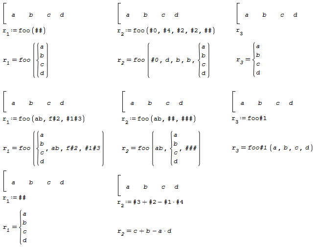

Plugin updated.
Changes:
- fixed image handling functions (READRGB(),...);
- the appearance of brackets has been changed;
- added the ability to explicitly specify an insert for MathcadBlock (##, #1, #2, ...).

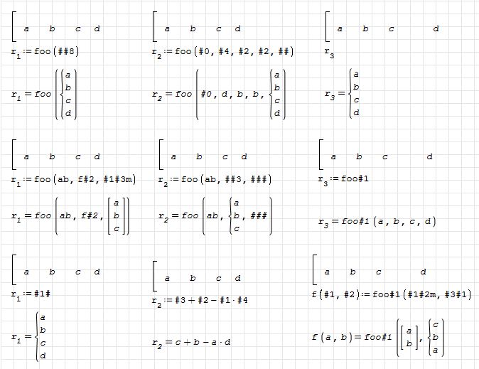

Expanding the idea of ​​numbering, we can add syntax:
## - take all as sys|mat|line
#i#j - take from i to j
##j - take from 1 to j
#i# - take from i to end
and
#i#js - sys(#i,..,#j)
#i#jm - mat(#i,..,#j)
#i#jl - line(#i,..,#j)
#i#jfun - fun(#i,..,#j)
or
### - insert as parameters: foo(x,y,###) -> foo(x,y,#1,#2,...)
##3# - insert as parameters: foo(x,y,##3#) -> foo(x,y,#1,#2,#3)

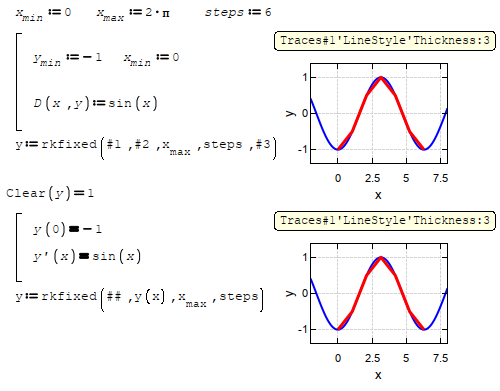

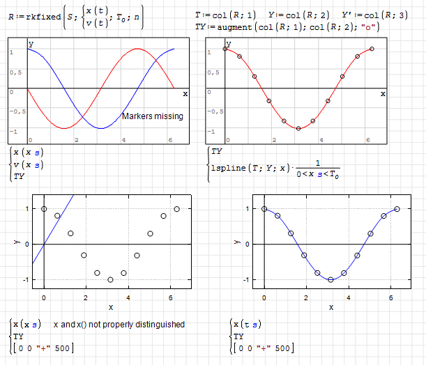

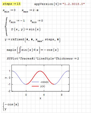

I encountered a plot problem with the list version of rkfixed(). Probably this also applies to other ODE-integrators with embedded function assignment.
In the native 2D Plot:
- When plotting a solution function along with a matrix of marker points, then the points won't display
- Yet, when using lspline() directly, both objects plot without problems.
In X-Y Plot:
- When the independent variable has the same name as the solution function (e.g. x(x), then x() is not treated as a function but as the expression x (similar with v(v) or any other name).
- A workaround is to use a variable name different from the function name. Yet this is strange, because in SMath x() and x usually are independent objects.
plotproblem.sm (30,62 КиБ) скачан 1682 раз(а).

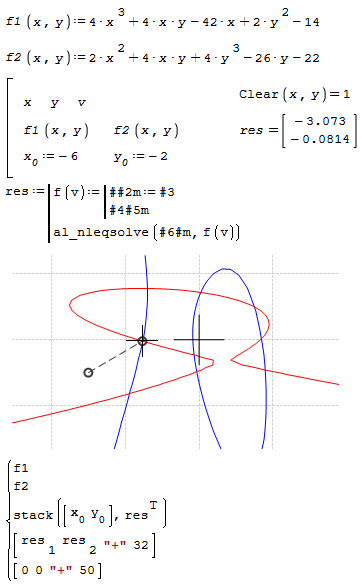

mathcadblock-alnleqsolve.sm (12,12 КиБ) скачан 1779 раз(а).
Alvaro 16.11.2024 08:51:00

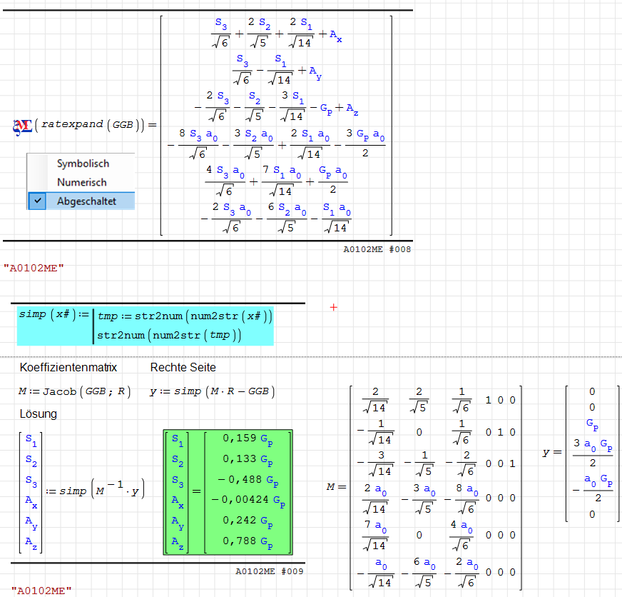

#189 Опубликовано: 15.11.2024 16:11:09

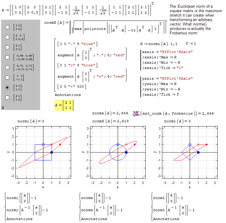

Visualization of transformations and matrix norms using implicit plots and automatic scaling of the X-Y plots.
Matrixnormen 2D.sm (28,12 КиБ) скачан 1728 раз(а).
ioan92 15.11.2024 21:21:00, Вячеслав Мезенцев 15.11.2024 16:24:00, Oscar Campo 15.11.2024 17:41:00

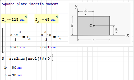

I suggest a handbook like Martin's one, with examples where the user can reuse the code (Code reusability is the technical expression for when you don't want to say that you are going to copy and paste). Or like Mathcad quicksheets. This is my idea of a clean use of the block for solving high school problems.
BasicHandbook-nsol.pdf (352,52 КиБ) скачан 1070 раз(а).
BasicHandbook-nsol.sm (327,84 КиБ) скачан 1835 раз(а).

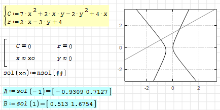

#192 Опубликовано: 13.12.2024 20:06:09
I'd like to have such things like nsol in SMath core.

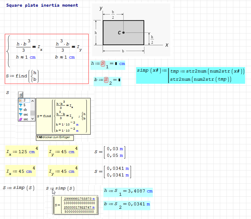

How about embedded assignment, similar to FindRoot? I don't like poking the values out of S. I see that this might reduce flexibility, e.g. in the case of parametrized initial guess.
I tried to demonstrate a generic approach, i.e. you get the variables assigned without having to issue any specific command except for the generic content of the placeholder. It is just a try and fails with single variables but you get the idea.
Of course, one would like to have a solve block without the cryptic generic expression in the placeholder.
Perhaps, such a block could be created from the insert menu with pre-allocated content of the placeholder and with setting it to hidden.
BasicHandbook-nsol_Kr.sm (333,12 КиБ) скачан 1782 раз(а).
Alvaro 13.12.2024 22:00:00

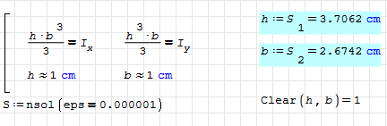

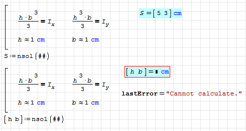

#193 Опубликовано: 13.12.2024 22:21:36
Hi Martin. I put "0" as argument because there are no more args. The second could be a vector of options, like this:
or the solved variables. Also, I use "S" because this error, which I imagine that could be corrected, but don't know how hard it could be:
PD: Notice that x# : transpose(str2num(x#))*diag(U#) or x# : diag(U#)*str2num(x#) if you want to return the answer as column vector, like normal people, returns x# as scalar if length(x#) = 1.

There are some problems with obtaining the values ​​themselves. Their nature is still unclear. This is the first trial implementation.
Отредактировано 21.08.2025 13:23:20
#198 Опубликовано: 21.08.2025 14:13:10
This effect is called a "classic case of circular dependency"
Never use the same variables for initial approximations and to store results - AI advised me.
Martin Kraska 21.08.2025 20:59:57

The problem is in the delayed evaluation. It is nice if you want to evaluate the solution for multiple configurations with S just storing the task instead of the solution.
It may well be fine to have this behaviour by design, but then we should not get an error message (undefined Ix).
So my proposal is
- if the solution can be found numerically with the data given at processing of the block, then store the data and not the task description.
- if the task has undefined variables other than the solution variables, then just store the task description (as it is done now but don't complain.
If you enforce intermediate evaluation, then there are no restrictions on the variable names any more. The recursivity is broken.
BTW, I'd propose to allow for scalar arguments for the single equation/single variable case.

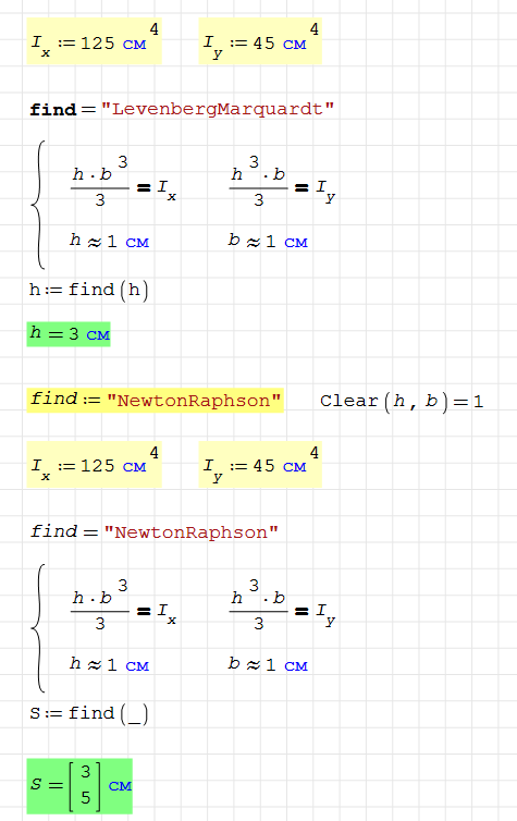

#200 Опубликовано: 21.08.2025 18:43:51
SMath Studio compatibility History page Changes AI Assistant
Plugin updated.
Changes:

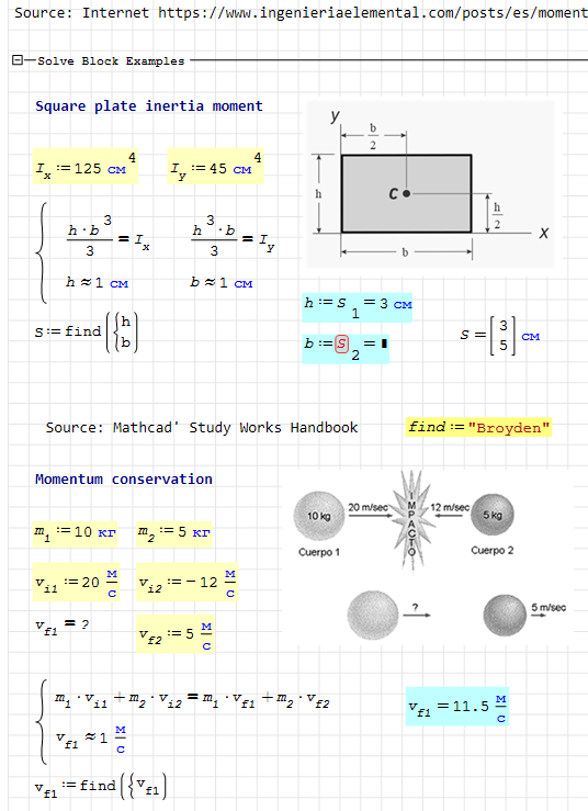

Refactors the `find` function to be more powerful and intuitive, aligning its behavior with user expectations from similar math software.
- The set of variables to be solved is now implicitly determined from all initial guesses (`≈`) provided in the input system. This removes the need to explicitly declare all variables.
- The function signature is now more flexible. Users can either omit the variable list to get all results, or specify which variables they want returned.
- Output variables can be specified either as a flat list (`find(sys, x, y)`) or as a `sys`/`mat` block (`find(sys, sys(x,y))`).
- Introduces `_` as a wildcard argument (`find(sys, _)` or `MathcadBlock -> find(_)`). This provides an elegant way to explicitly request all solved variables, which is particularly useful for integration with `MathcadBlock`.
- The output is now filtered to return only the subset of variables requested by the user, in the specified order.
Available nonlinear solvers: FixedPoint, LevenbergMarquardt, NewtonRaphson, Broyden.
Default solver: "LevenbergMarquardt"
Understanding the Calculation Behavior. A Circular Dependency (Gemini).pdf (87,1 КиБ) скачан 707 раз(а).
