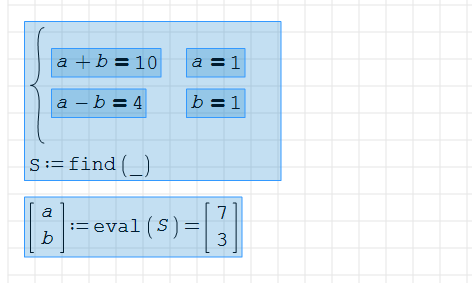

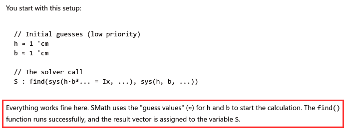

I think that the explanation by Gemini is not entirely correct. Yet, he hint on circularity is helpful.
If that was true, we would not have that circularity problem. Also we would not see the entire find command with it's arguments if we display the stored expression from the find block in the dynamic assistant.

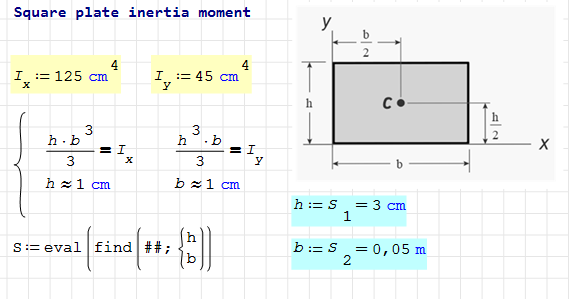

Actually I believe that the find function (like any other function in any assignment does nothing (except for substituting existing definitions from the context) unless a result display is requested. I call this delayed evaluation.
Also, assignment to a variable should not affect anything above the current definition. Backfiring should be limited to absolute variables as sometimes used for iterations with on-the-fly animation.
If Gemini was right here, the simp() function in my above example would not help. simp() actually triggers evaluation because num2str() does so. BTW, in the given case S: eval(S) also does the job.

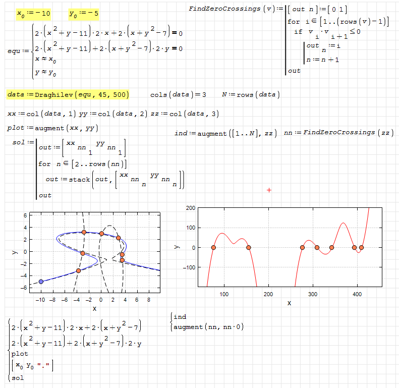

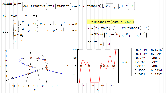

... Draghilev solver added.
Hi Viacheslav. With a matrix non-zero finder, like the one in Matlab, you can simplify the axis crossing detection.
MathcadToolbox-Draghilev-MFind.sm (30,45 КиБ) скачан 1409 раз(а).
Сan be used as a temporary solution.

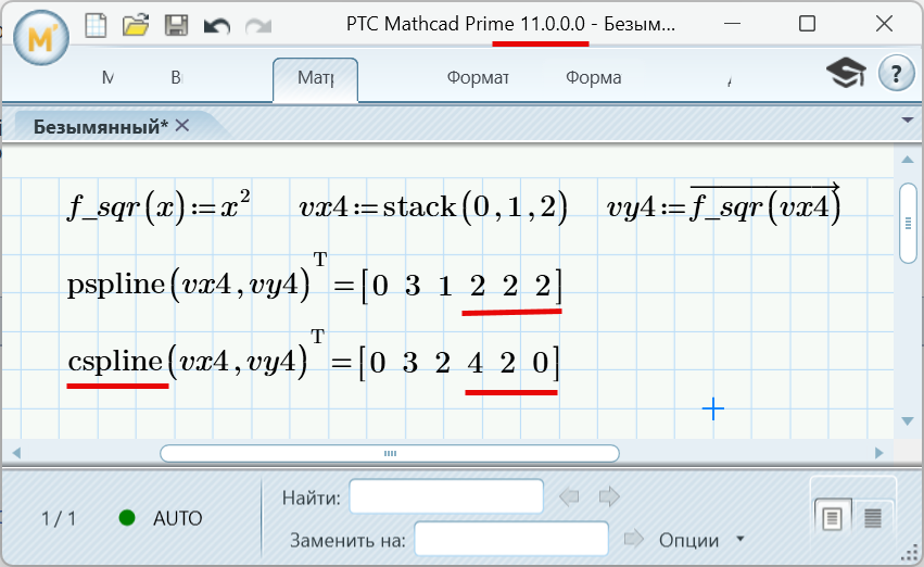

AI also helped to understand splines. It found an inaccuracy in the Mathcad.

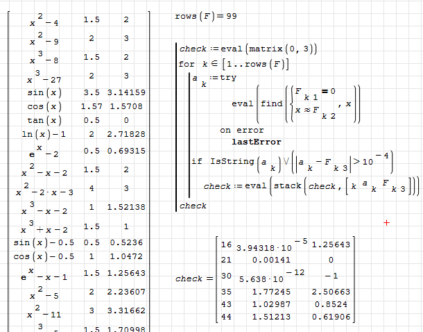

Hi Viacheslav. You also can ask the IA for matrices with known examples to check the answers. In this case, one variable function, the guess and the root.
check-find.sm (37,51 КиБ) скачан 1258 раз(а).
Вячеслав Мезенцев 24.08.2025 05:51:44, Oscar Campo 24.08.2025 09:54:25, francesco rapuano 24.08.2025 14:41:15

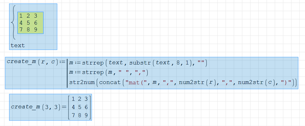

Mathcad block for entering matrices. This allows for inserting and deleting rows and columns using ordinary SMath edit. Each entry is a formula cell.
Problem is that it is easy to get the wrong sequence by slightly misplacing entries.
Also, it is not nice that the procedure can't guess the shape of the matrix from the arrangement of the entries.

Hi, I see you're using the character at position 8 to find the newline. The text inside the mathcad block uses a different character than the one used in the text inside a description(). One way to get both is this (Carriage Return & Line Feed)
You can then handle text from both the mathcad block and description(), for example, using strrep(text,'CR,'LF)

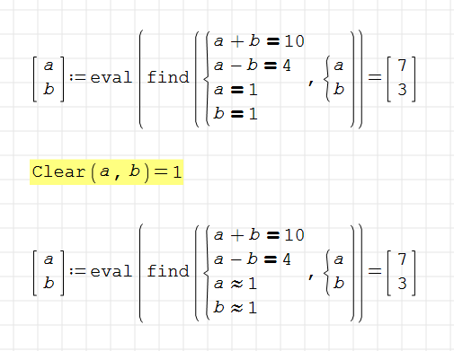

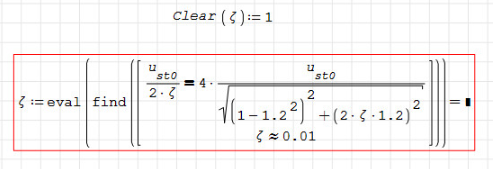

These equations used to work in the original document, but today they all show red. Then I copy them and paste them to a new blank document, the 1st and 2nd equ works except 3rd one.
#215 Опубликовано: 31.08.2025 09:46:57

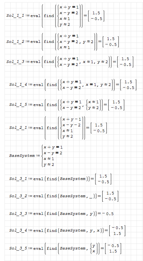

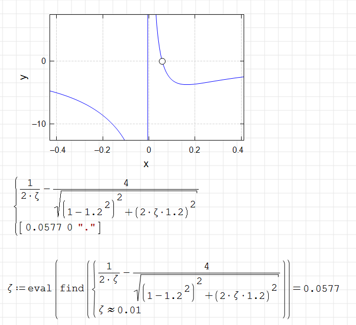

This is the basic form of using the find() function.
All other methods should be used after mastering the basic ones.
Отредактировано 31.08.2025 09:49:53
use Clear() function between 2nd and 3rd equations and evaluate:
When this function is evaluated, the value of arguments in the function are cleaned.
Oscar

Hi. Usually, isn't easy verify the calculus from a picture, it's better from the source. You use ":=", instead "=", as Oscar suggest.
Отредактировано 01.09.2025 06:41:26

Pay attention to this convention:
When you type ":" in SMath, you are assigneing a value to a variable and SMath renders as: ":=" .
When you type "=", you are asking for the value of a variable, or evaluating a function, and smath renders it as: "="
In your case, Clear() is a function, so, when you type "Clear(z[Ctrl+g]):1" which renders:
Here you must to type "1" and you are assigning the value "1" to "Clear(zeta)" . This is wrong.
The correct syntaxis to evaluate the function Clear() is : "Clear(z[Ctrl+g])=" which renders:
Here you don't type "1". The value "1" is an automatic response to evaluation of the function Clear(). It is the boolean answer of successfully having evaluated the Clear() function
Best,
Oscar
