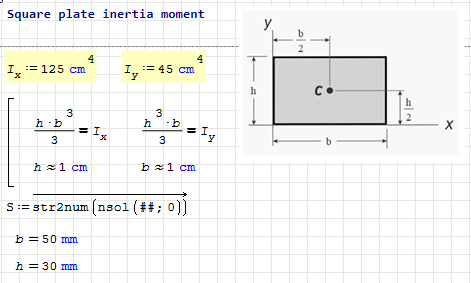

WroteImagine that you can formalize the solution to a simple problem. What would you suggest as educational examples?
I suggest a handbook like Martin's one, with examples where the user can reuse the code (Code reusability is the technical expression for when you don't want to say that you are going to copy and paste). Or like Mathcad quicksheets. This is my idea of a clean use of the block for solving high school problems.
BasicHandbook-nsol.pdf (352.52 KiB) downloaded 1070 time(s).
BasicHandbook-nsol.sm (327.84 KiB) downloaded 1835 time(s).
5 users liked this post
francesco rapuano 12/13/2024 6:43:00 PM, Вячеслав Мезенцев 12/13/2024 11:41:00 PM, NDTM Amarasekera 12/13/2024 7:02:00 PM, Martin Kraska 12/13/2024 8:06:00 PM, sergio 12/13/2024 9:15:00 PM
#192 Posted: 12/13/2024 8:06:09 PM
I'd like to have such things like nsol in SMath core.

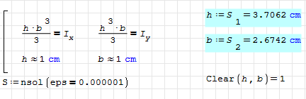

How about embedded assignment, similar to FindRoot? I don't like poking the values out of S. I see that this might reduce flexibility, e.g. in the case of parametrized initial guess.
I tried to demonstrate a generic approach, i.e. you get the variables assigned without having to issue any specific command except for the generic content of the placeholder. It is just a try and fails with single variables but you get the idea.
Of course, one would like to have a solve block without the cryptic generic expression in the placeholder.
Perhaps, such a block could be created from the insert menu with pre-allocated content of the placeholder and with setting it to hidden.

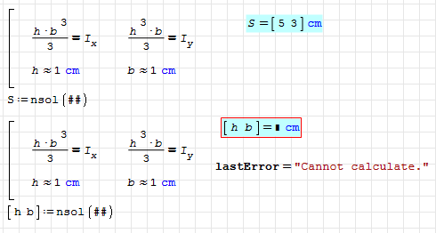

#193 Posted: 12/13/2024 10:21:36 PM
Hi Martin. I put "0" as argument because there are no more args. The second could be a vector of options, like this:
or the solved variables. Also, I use "S" because this error, which I imagine that could be corrected, but don't know how hard it could be:
PD: Notice that x# : transpose(str2num(x#))*diag(U#) or x# : diag(U#)*str2num(x#) if you want to return the answer as column vector, like normal people, returns x# as scalar if length(x#) = 1.
#194 Posted: 12/14/2024 7:36:10 AM
Wrote... How about embedded assignment, similar to FindRoot? I don't like poking the values out of S. I see that this might reduce flexibility, e.g. in the case of parametrized initial guess
Hi Martin. I think the opposite: the implicit assignment of the names of the variables sought to a solution makes its call very rigid, since many times there is no direct relationship between the variables of the equation and the names of the variables that are intended to be assigned to the solution, as is precisely demonstrated in this case
Another variant among many would be to find a limiting speed and call the result v.lim, even though the variable of the equation is "v".
