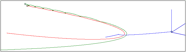

Hi. Very interesting. It could be animated and add z axis. Maybe speed vectors too and the "ecliptic" plane.
3body.sm (37.44 KiB) downloaded 1611 time(s).
Вячеслав Мезенцев 4/2/2023 9:33:00 AM
#144 Posted: 4/2/2023 9:34:42 AM
1,555 likes in 1,867 posts.
It is necessary to choose the conditions of the problem in such a way that the massive body intercepts the satellite.
Hi. Ok.
3body.sm (37.78 KiB) downloaded 1598 time(s).

#148 Posted: 4/3/2023 4:19:19 AM
Hi. Ok.
A very witty, funny and clean solution.

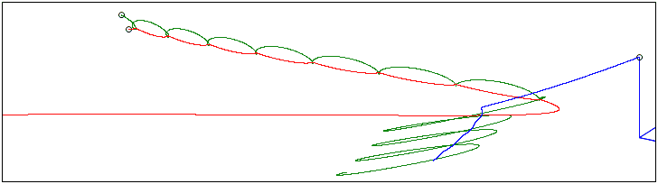

#149 Posted: 4/4/2023 1:59:18 AM
Little bit more.
Click to enlarge
7-13-Three-Planets 6 (Mathcad Block).sm (26.11 KiB) downloaded 2050 time(s).
7-13-Three-Planets 6 (Mathcad Block).pdf (67.28 KiB) downloaded 974 time(s).

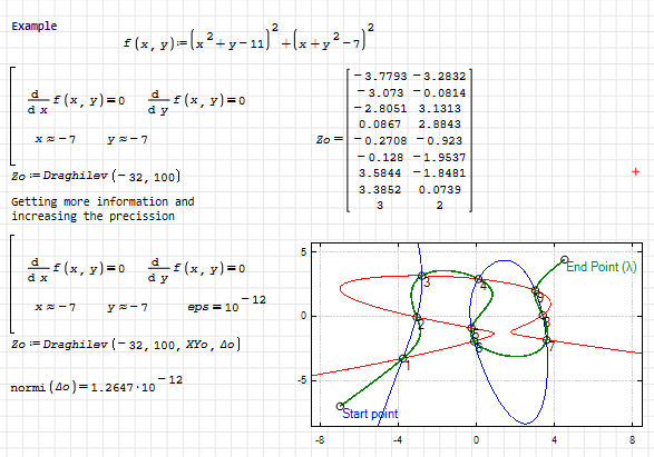

Utility for call dsolvers for initial and boundary values problems from a solver block.
RKA.pdf (931.16 KiB) downloaded 1625 time(s).
RKA.sm (308.62 KiB) downloaded 2145 time(s).

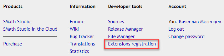

Hi. That function looks great. Is there an example of using a document as an add-on?
Try to log in here using the registration data in the program: https://en.smath.com/upload/extensions.aspx
You should see this picture:
Click to enlarge
Next, you need to choose the type of extension
Click to enlarge
Before uploading a file, you need to fill in the document properties. Later, you can delete the file if necessary.
Click to enlarge
If the registration data is not suitable, then you need to request them from Andrey via e-mail.

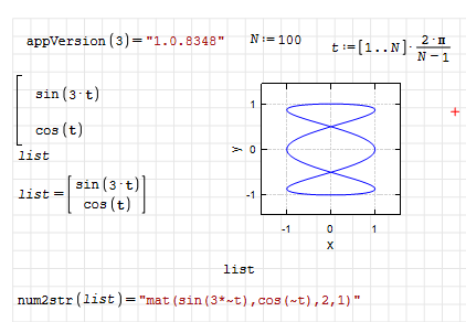

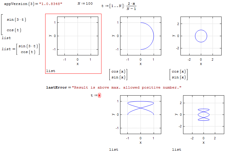

#159 Posted: 4/17/2023 4:43:23 PM
Unfortunately, I can't reproduce your parametric plot example.
It seems that the parameter range is taken from the x axis limits. Assigning a range to the parameter makes the plot fail.
How to fix this?
BTW, how about making the glyph of the mathcad block reflect the actual type by using {,[ or | to indicate the vertical extension?
Mathcad block.sm (13.77 KiB) downloaded 1608 time(s).
#160 Posted: 4/17/2023 5:22:41 PM
...How to fix this? ...
Use ~t instead t in list, but t in the range.
