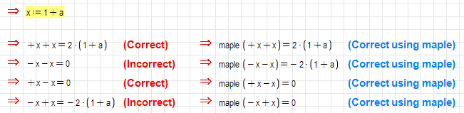

SMath Forum SMath Studio Questions Why does SMath give incorrect results? 1 Pages (2 items) Why does SMath give incorrect results? - Error in simple algebraic operations - Messages #1 Posted: 2/23/2024 6:54:33 PM Israel Espinoza 0 likes in 1 posts. Group: User Why does SMath's algebraic engine give wrong results in basic algebraic operations? How to solve it without using extensions such as Maple? #2 Posted: 2/23/2024 9:57:29 PM StvMath 35 likes in 56 posts. Group: User How to solve it without using extensions such as Maple?SMath doesn't seem to like starting with a unary minus. Try: 1 users liked this postIsrael Espinoza 2/24/2024 2:25:00 AM 1 Pages (2 items) New Posts No New Posts
