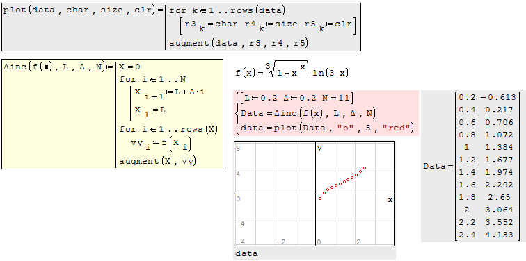

#7 Posted: 3/14/2020 6:06:47 AM
1,355 likes in 2,270 posts.
You can do the job using a while loop but it is just one option (perhaps not the most straightforward one).
loops.sm (10 KiB) downloaded 1058 time(s).

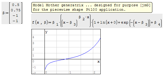

Golden ratio will be a life time productive Companion.
As well as an advanced WhileLoop.
Golden Ratio jmG.sm (39.41 KiB) downloaded 1014 time(s).

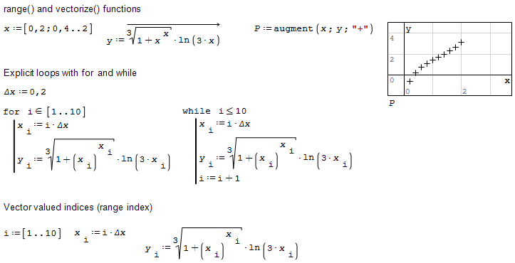

#13 Posted: 3/14/2020 11:20:50 AM
1,443 likes in 2,935 posts.
so is it possible to check this function with while loop, or no?
Absolutely, and there are several ways.
If you need a step-by step feedback on the fly you can use breakpoints (menu of math regions) and the debugger window ("View" menu). You might have to store the intermediate results in a dedicated variable though, to don't look into the whole matrix at each step.
Also you can use the function trace() and the output window, or you can build math strings using concat() and other functions, or maybe something more complex using the script region plugin by uni.
loops-1.sm (30.01 KiB) downloaded 969 time(s).
