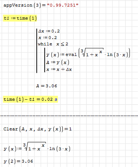

Hi everyone, I've got problem with while loop. I have this function with Xstart = 0.2 ; Xfinish = 2 ; deltaX = 0.2 and I need to solve it in smath studio, but while loop is processing forever and never ends. I'm doing something wrong, or it's a bug? Thanks!

#2 Опубликовано: 13.03.2020 16:58:44
NDTM Amarasekera
NDTM Amarasekera
Is this what you need?
#3 Опубликовано: 13.03.2020 17:14:41
Yes Man
Yes Man
No, I need a range of numbers for X and Y, like: First X = 0.2, it's calculating Y(0.2) and shows first Y result, then X = 0.4 (previous X + delta X) and it's calculating Y(0.4), and until x = 2. In final I need a range of all X and all Y results.

I'm not sure I understood how to solve my function by this examples.
I don't know what I'm doing wrong:
https://postimg.cc/Q9mqWkKd

I can type every y(x) in smath studio:
https://postimg.cc/0bddLTqF
But, is it possible to do it with while loop?

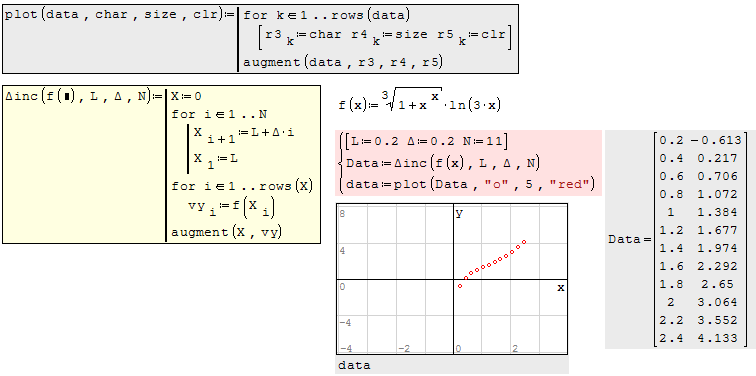

#10 Опубликовано: 14.03.2020 08:25:47
What you are asking for is so restricted and useless for purpose !
Then you can:
1. start wherever [L] as long as computable your ln(,)
2. end wherever [N]
3. as fine step size [Δ]
4. algo style for infinite applications

#13 Опубликовано: 14.03.2020 11:20:50
1 436 сообщений из 2 916 понравились пользователям.
so is it possible to check this function with while loop, or no?
Absolutely, and there are several ways.
If you need a step-by step feedback on the fly you can use breakpoints (menu of math regions) and the debugger window ("View" menu). You might have to store the intermediate results in a dedicated variable though, to don't look into the whole matrix at each step.
Also you can use the function trace() and the output window, or you can build math strings using concat() and other functions, or maybe something more complex using the script region plugin by uni.
loops-1.sm (30,01 КиБ) скачан 676 раз(а).
