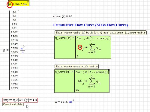

I get an error when using the same variable name in worksheet and inside the program loop.
Why do I get this?
In many earlier SS versions (can't remember versions) it worked perfect
Assignment Error with Units in Program Loop.sm (7.64 KiB) downloaded 1023 time(s).

#4 Posted: 4/14/2018 10:45:49 AM
... added the note wrt scalar Σ
Assignment Error with Units in Program Loop[1].sm (15.84 KiB) downloaded 819 time(s).
