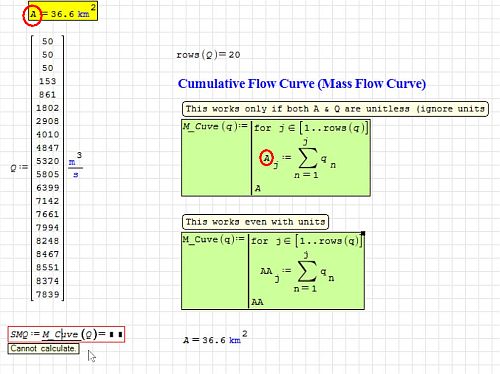

I get an error when using the same variable name in worksheet and inside the program loop.
Why do I get this?
In many earlier SS versions (can't remember versions) it worked perfect
Assignment Error with Units in Program Loop.sm (7,64 КиБ) скачан 1134 раз(а).

look here
frapuano 14.04.2018 10:26:00

Thanks Davide. I got it.
#4 Опубликовано: 14.04.2018 10:45:49
... added the note wrt scalar Σ
Assignment Error with Units in Program Loop[1].sm (15,84 КиБ) скачан 930 раз(а).

Thanks Jean for the useful tips.
