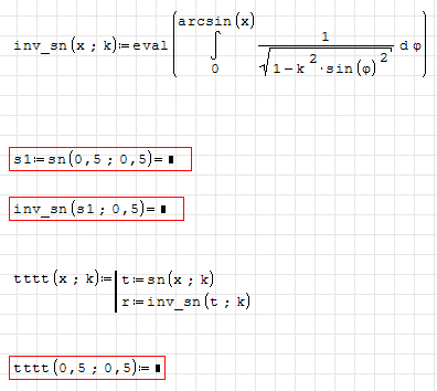

Please look at the attached worksheet.
function inv_sn(x,k) works fine in the main body, but fails is called from another function.
inv_sn.sm (4.61 KiB) downloaded 1110 time(s).

You have to first define the function "sn".
To evaluate "tttt" uses the "=" not ": =".
Carlos
It should be noted that sn() seemingly depends on uni's EFI for Mathcad libraries; also, it's 32-bit only iirc. So, it OP wants others to see what he sees, he should mention the dependencies.
Here's what e.g. I see:

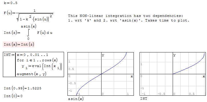

... previously answered but let's see it.
