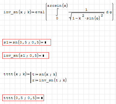

Please look at the attached worksheet.
function inv_sn(x,k) works fine in the main body, but fails is called from another function.
inv_sn.sm (4,61 КиБ) скачан 1110 раз(а).

You have to first define the function "sn".
To evaluate "tttt" uses the "=" not ": =".
It should be noted that sn() seemingly depends on uni's EFI for Mathcad libraries; also, it's 32-bit only iirc. So, it OP wants others to see what he sees, he should mention the dependencies.
Here's what e.g. I see:
С уважением, Михаил Каганский

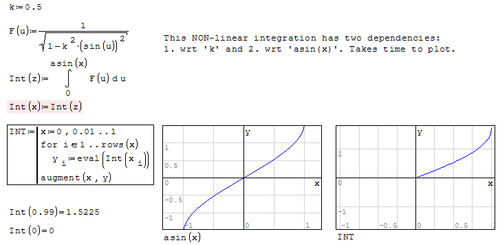

#4 Опубликовано: 06.10.2016 23:15:53
... previously answered but let's see it.
