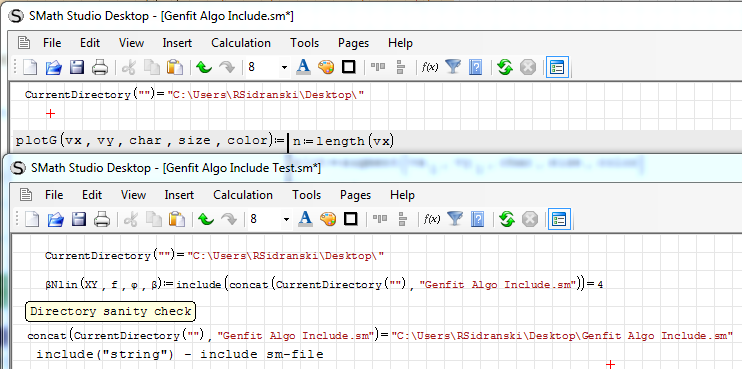

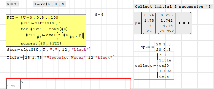

Using Jean's files in the same directory, I updated to Mike's sheet and compared it to UNI's pdf ... I still have an error in the re-definition of BETA. Using latest SMath and plugins.
This is on my work computer ... not the one at home.
BTW, I tried with both files on my desktop and in the "C" drive.

#103 Posted: 4/15/2016 11:43:26 PM
Ruben Sidranski
Ruben Sidranski
17 likes in 465 posts.
Not that BETA ... the one to the right of "FIT" per my screenshot. Everything up to that point matches UNI's PDF. I've tried moving the "BETA" down. I think that is why I have red boxes below.
#104 Posted: 4/16/2016 12:10:09 AM
уни
уни
156 likes in 355 posts.
βNlin() redefined (βNlin() := include() = 4).

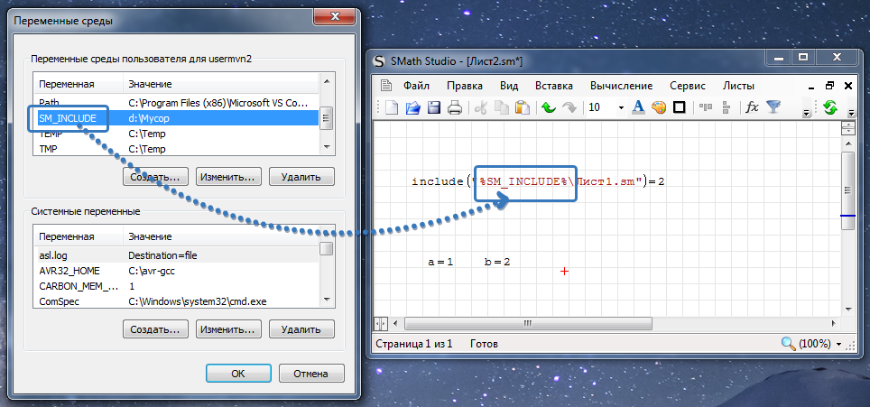

Hi!
Access to Windows Enviroment Variables would be really nice:
include("%SM_INCLUDE%\fn.sm"=10
Do you think it's possible?
Thank you
#106 Posted: 7/26/2017 2:31:54 AM
1,555 likes in 1,867 posts.
Yes, it is possible. Will be in new release.

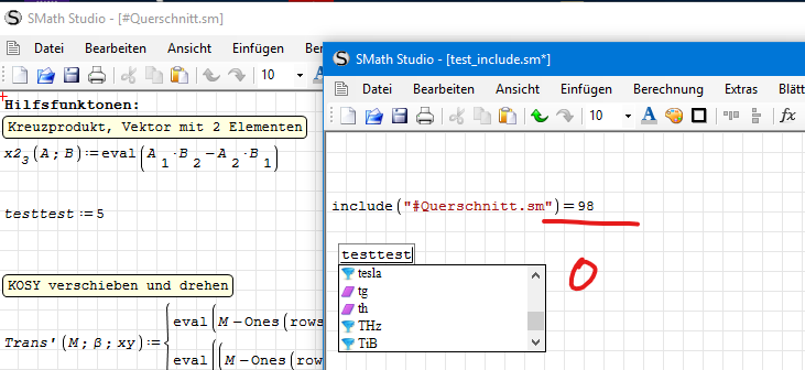

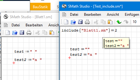

found a little bug in include():
Strings containing only one space " " are imported as an empty string.
Вячеслав Мезенцев 2/22/2019 8:40:00 AM
#113 Posted: 2/22/2019 8:40:39 AM
Updated. Try now.

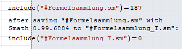

Martin_B
Martin_B
22 likes in 84 posts.
Updated. Try now.
Is working, with 0.99.6988

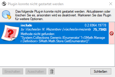

Thanks a lot.
Could you update the plugin for the latest stable, please?

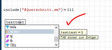

Edit:
I have a more comprehensive sheet, which I include:
now (0.99.6988 with updated include extension) the result of include is shown as usual (98 elements), but they are not accessible:
At first start a few equations were present, but finally I can't get it to work.
I can't even say, if the beta Smath app or if the extension is making troubles.
The old extension 0.2.6982.28030 works correctly, apart from " ".
