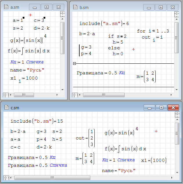

You can include sm-file containing a simple set of definitions.
How to use: include("myfile.sm" )=
Note. The dependencies of the include file may differ from the current set of plugins or have different versions. In this case, you need to check that the included file is calculated correctly.

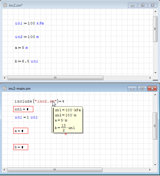

I was just playing bit with include(). I just figured out that the hoovering over the include there will be presented the alphabetical order of variables, the variables with dot in its name will be ignored. As I could understand only the assignment of variables will work - but not always (complicated structures will be ignored). Now, there is a bit of problem to kepp the track about which variables have been defined with include(). Maybe a list of them to be available?
EDIT: Hmm...uni posted this a minute before I posted this one. I will check function definitions - it did not work for me.
EDIT1: It is working regarding functions, but the dot in the names is still ignored. Variables are not now in the alphabetical order

Yes, it seems ok now. Dot is working inside a variable name.
Thank you.
EDIT: Suppose that units are not handled yet
EDIT1: Yes, units are handled now .
