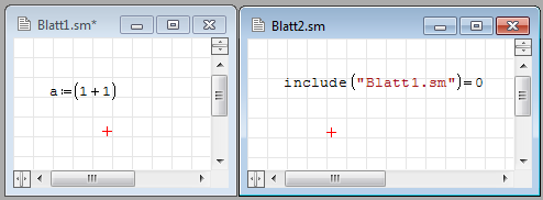

I am finally able to create a minimal example that reproduces the bug, see attachment. Include() seems not to work with brackets.
Вячеслав Мезенцев 10/28/2014 5:38:00 AM
Updated. Bug fixed. Brackets now supported.

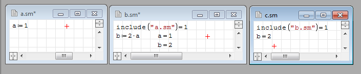

I would like to use cascading dependencies. See the attached example. In file c.sm I cannot access all the variables I have in b.sm. Nevertheless I have the influence of a.sm in c.sm through the variable b. This is strange to me. Is it a wanted behavior? Why?
Of course I could include a.sm in c.sm again. But I could also include another file d.sm in c.sm which contains a:=2. I would then end up with a=2 and b=2 despite b being defined as 2*a...
I think there are two ways of implementing this properly:
  1. You can acess all the variables like a class. I.e c:=include( "a.sm" ) ... c.a=1
  2. Or the variables are universally accessible in all files directly, resulting in a=1 in c.sm
Вячеслав Мезенцев 10/30/2014 6:47:00 AM

There is a log file in the folder with the plugin (it appears if the function doesn't work.). The function can't find the file in the specified path. As for the rest - it's strange behavior. I'll see what's wrong.

1,554 likes in 1,864 posts.
Updated. Fixed bug with cascading dependencies.

Thanks, now it works in the manner that all variables are accessible in all the following sheets. It is slow however.

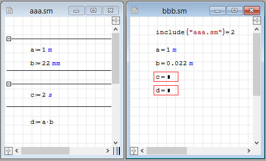

It looks like there is a bug if you include Areas in the source file.
If your data is included in more than 2 Areas, the plugin will send only the content of the first one.
Вячеслав Мезенцев 12/1/2014 1:27:00 PM

I think this is not only my bug. I ask Andrey about it.
We found the problem. This issue is related to saving the file. Andrey will make the correction in the next build.
