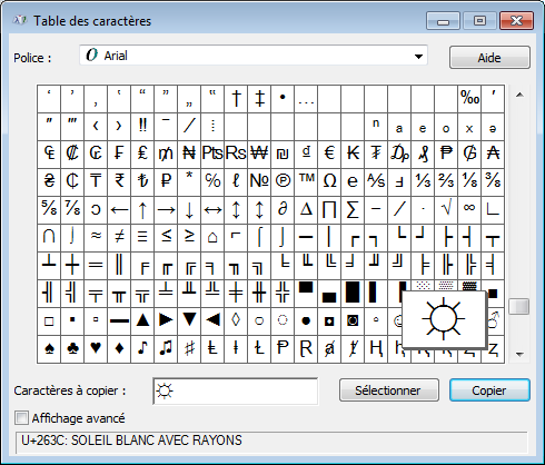

Hi IAks,
You don't need a plugin, just the right Unicode character (you can copy and paste the character from one site like Wikipedia, tamasoft.co.jp, alanwood.net or you can add the character holding the U and typing a #CODE# from the numpad)
look the attachments

#5 Posted: 11/7/2018 8:51:32 AM
I'm not sure why or how U+code was working in my previous Windows 7 OS...
I'm aware that paste doesn't work in variable typing (you can only select a whole variable and replace it); as workaround you have to build the variable in a text/writer region (or notepad) and paste it.
If you use writer region and you know the character code you can use CTRL+SHIFT+X (on hexadecimal code) / CTRL+SHIFT+D (on decimal code)
Without cnversion, in any text editor/region you have to wrap the uppercase code in slashes
All numbers are available as subscript/superscipt characters, although superscript 123 are in a different unicode block and might be rendered differently (uniode superscript/subscript ).
SO4\207B\\00B2\
¹²³⁴⁵⁶⁷⁸⁹⁰⁺⁻

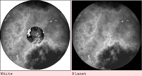

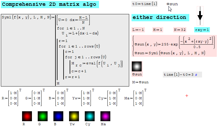

WroteIn astronomy I need to use a symbol that looks like a circle with a dot in the middle as a subscript
... from 6 years old .
Tentatively we can highlight a specific circular region.
The attached were left unfinished.
Image Planet Luminosity_1.sm (100.57 KiB) downloaded 1170 time(s).
Image Planet c(planet)planet.sm (79.22 KiB) downloaded 1172 time(s).
Image Planet fmap.sm (183.45 KiB) downloaded 1194 time(s).
Image Planet Luminosity.sm (219.14 KiB) downloaded 1125 time(s).
Image Planet Luminosity_2.sm (236.04 KiB) downloaded 1158 time(s).
Image Planet Gamma.sm (315.73 KiB) downloaded 1214 time(s).
