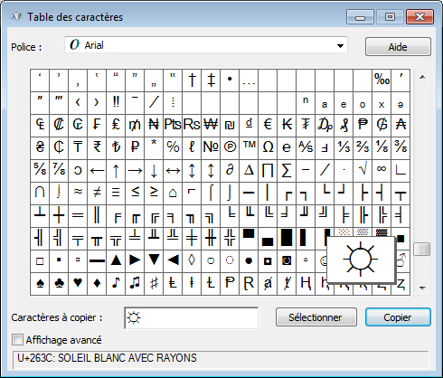

Hi IAks,
You don't need a plugin, just the right Unicode character (you can copy and paste the character from one site like Wikipedia, tamasoft.co.jp, alanwood.net or you can add the character holding the U and typing a #CODE# from the numpad)
look the attachments
regards,
w3b5urf3r

Hi Davide
sorry for the newbie question but how did you enter the the Sun Unicode character, I am trying to follow your suggestions without suceeding.
What do you mean for holding the U and typing a #CODE# from the numpad.
If I am holding U but the result is writing continuosly U on the canvas .
I am trying to do the same using the Ctrl+K method but have the same result. The only way to make it work is with the copy and paste technique ... but it works only for one single unicode character in a variable name if I need to place 2 or 3 unicode characters close together it doesn't works ( better to say that I am not able to do this).
To write Chemical concentration variables - that is the issue I am trying to address- for instance the concentration of [SO4]-2 I start from the superscript minus ( copy & past form a Unicode symbols page over Internet) then I add SO4 then I am not able to paste another unicode symbol for the superscript 2 , luckily exists the superscript 2 as an ALT sequence and so I was able to accomplish but if it was superscript 4 it was impossible (it doesn't exist an Alt sequence for it) .
Thanks in advance for your help and best regards
Franco

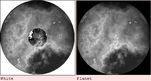

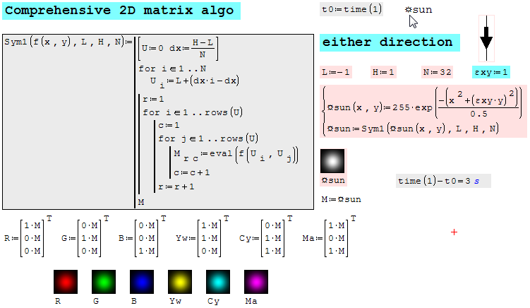

WroteIn astronomy I need to use a symbol that looks like a circle with a dot in the middle as a subscript
... from 6 years old .
Tentatively we can highlight a specific circular region.
The attached were left unfinished.
Image Planet Luminosity_1.sm (100,57 КиБ) скачан 1170 раз(а).
Image Planet c(planet)planet.sm (79,22 КиБ) скачан 1172 раз(а).
Image Planet fmap.sm (183,45 КиБ) скачан 1194 раз(а).
Image Planet Luminosity.sm (219,14 КиБ) скачан 1125 раз(а).
Image Planet Luminosity_2.sm (236,04 КиБ) скачан 1158 раз(а).
Image Planet Gamma.sm (315,73 КиБ) скачан 1214 раз(а).
